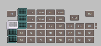

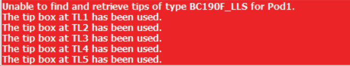

Not sure if you had this answered elsewhere, but I was able to get a similar snippit working for dynamic tip placement in my method
Dim t_arrMC200Tip(4)
Dim PosDeck
PosDeck = ""
For i=0 to 4
PosDeck = "TL"&i+1
t_arrMC200Tip(i) = PosDeck
Positions(PosDeck).AddNewLabware "BC190F_LLS", World
Next
Which generated this:
Setting volumes to 0 using >Positions(PosDeck).Labware.SetAllAmountsTo 0, LeftPod< right above the >Next command will remove tips. I believe Biomek Software uses volumes as one way to track tip count, but no sure how to use this info yet.

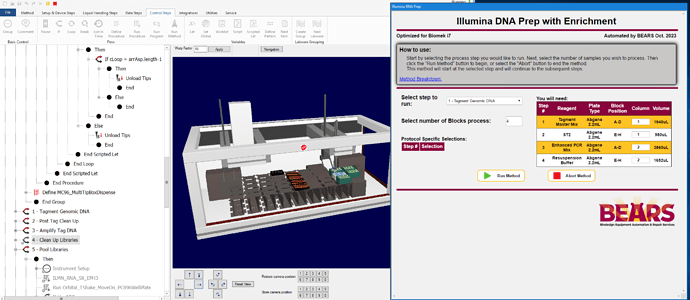

Here’s a little sample of a custom HTML prompt we’ve setup for a lab that uses a Biomek i7 for prepping and enriching DNA from wastewater samples for Illumina NGS runs. It dynamically generates the table based on the step a user selects and calculates and updates data in Biomek to be used by the method.
