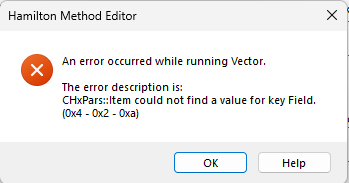

CHxPars:Item could not find a value for key Field
We’ve recently moved our fleet from Venus 4.5.0.7977 to Venus 6.0.1. This involves running many methods that were written in Venus 4 using the Venus 6 setup. The attached error is presenting when trying to modify the logic of the “If/Else” step in method editor. I am able to add steps within the if/else block, but I cannot directly edit the conditional evaluation. The method runs successfully in Run Control. Is there a way to circumvent this? It’s not a blocker, but will require remaking the If/Else blocks for future edits.

This is a known issue with VENUS 6.0.1. This was resolved with VENUS 6.0.2 and above. The if/else commands will continue to work at run time, but if any editing needs to be made you must delete the old and replace with a new if/else command.
