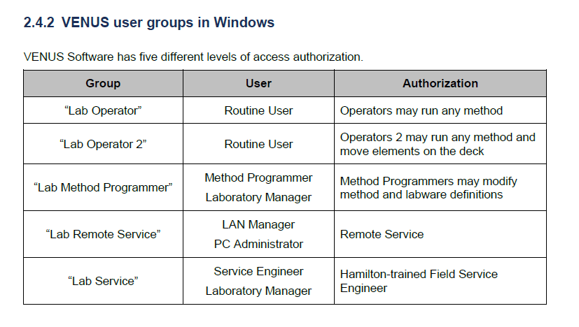

I am looking for documentation that describes the permissions and access rights associated with each user role in VENUS 6, specifically version 6.2.3.
I would like to understand what actions and functionalities are available to each role (Service, Method programmer and Operator), and whether there is an official matrix or guide that outlines these permissions in detail.
I have searched through the documentation available to me but have not been able to find a clear description of the role-based permissions.
Does anyone know if such a document exists, and if so, where it can be found?

Chapter 2.4 in the programmer manual of Venus 6 will do the trick for you.

Thank you for the information. However, I am looking for something more detailed than the general role descriptions.
Specifically, I would like to find documentation that clearly lists the permissions associated with each role. For example:
  • Which roles can import or export methods?
  • Which roles can access and modify Configuration System Editor settings?
  • Which roles can create, edit, or validate methods? …
Ideally, I am looking for a permission matrix that maps each role to the actions it is allowed to perform.
Do you know if such documentation exists for VENUS 6.2.3?
Thanks in advance.
See this link for the latest version of our VENUS 21 CFR Part 11 Guide, which breaks down the roles in more detail. This guide applies to earlier versions of VENUS as well as VENUS 6 and up.
