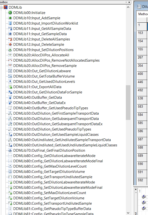

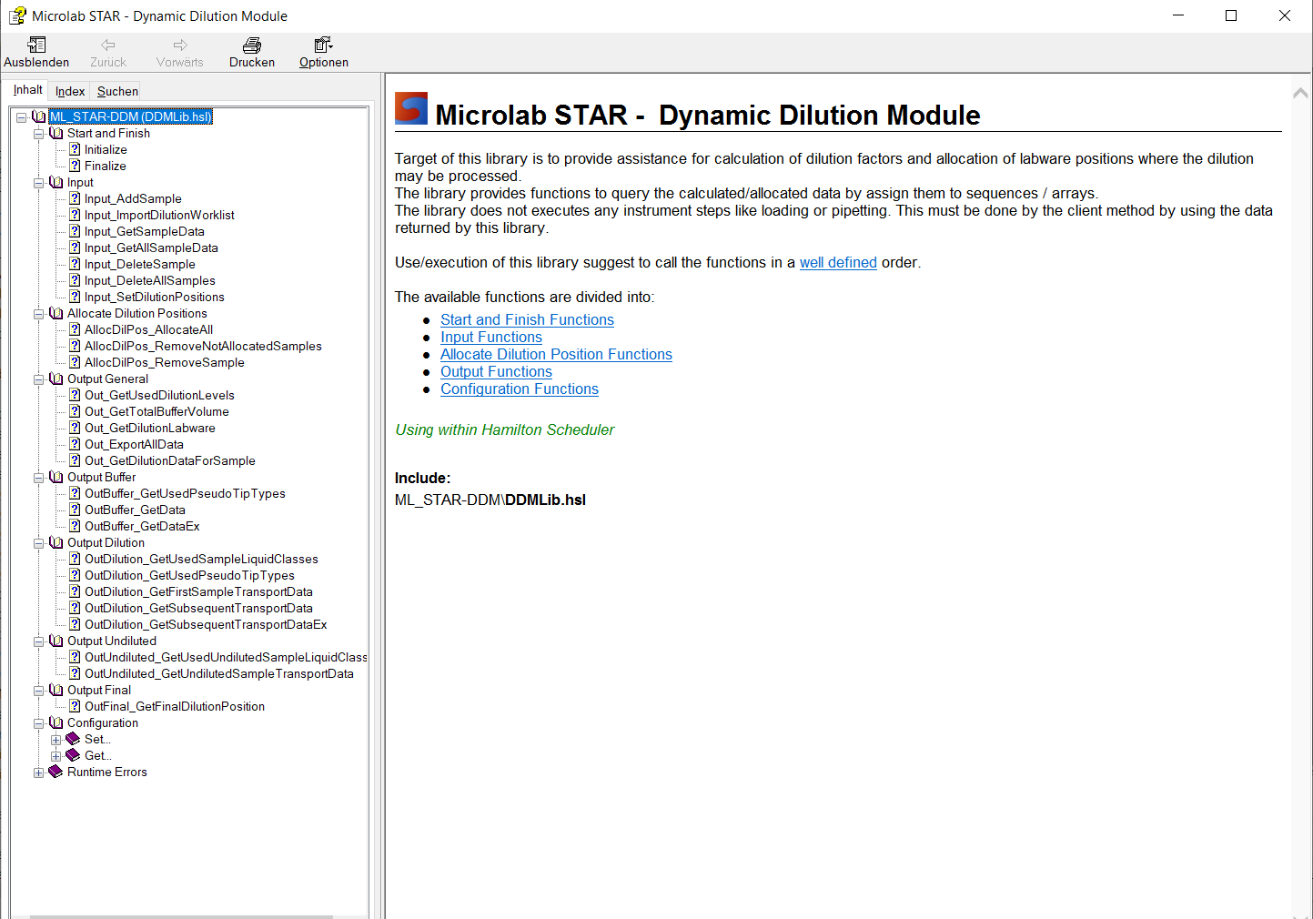

Hi Eric,
thanks for your reply, attached you can find some fast screenshots regarding the Library Toolbox/HelpMenu :slight_smile:
My samples need to be matched to a worklist, then based on the value of the column “Pre-Dilution factor” e.g. 0,…,20 a 1:X dilution should be performed on a seperate carrier/plate.
Then the positions of the created dilutions need to replace the original ones in the Load/Match Seqence before proceeding with standard addition, hydrolysis etc.
I thought the Library could be useful for data handling and allocation of dilution positions, though I dont really want to calculate dilution factors here.
