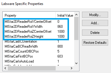

The trough itself is too short for the 1D autoload. For newer systems equipped with a 2D autoload and running VENUS 6, the labware properties could be modified so it can be read:
