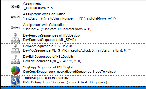

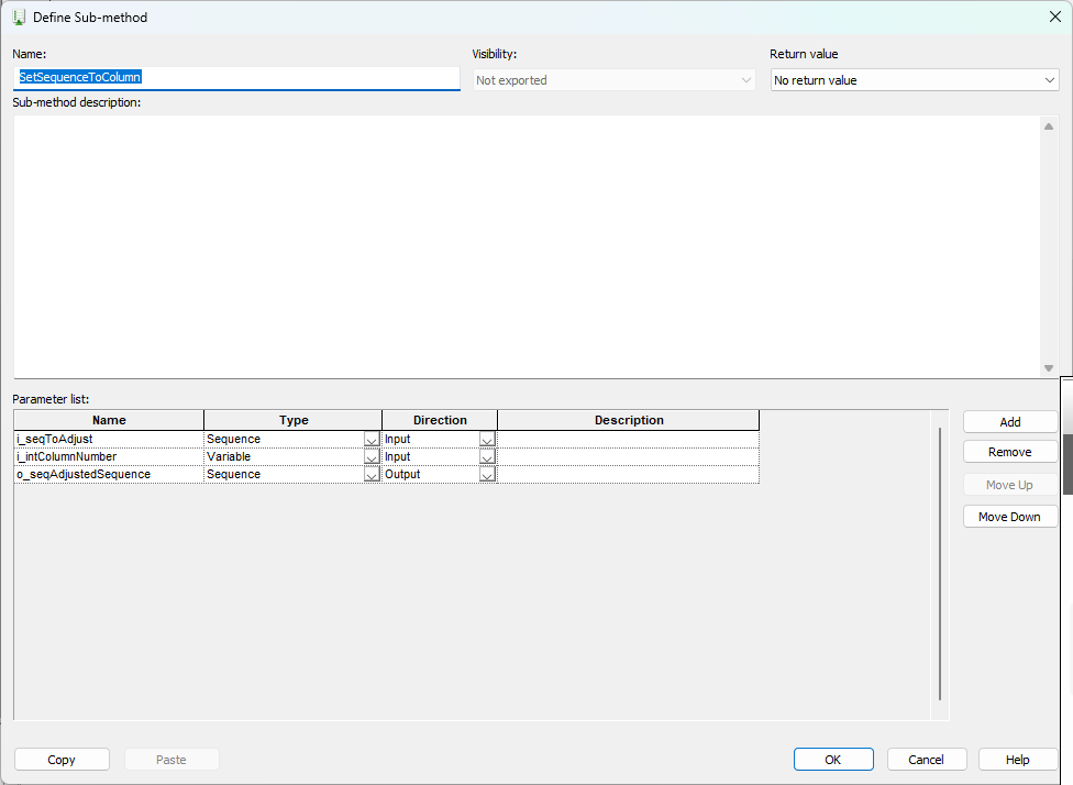

You actually can accomplish that with the HSLDevLib and the DevEditSequences functions. If you set the timeout time to 0, it won’t show the dialog for the sequence editing tool but will still edit the sequence based on the start and stop points that you calculate. See below for an example:
Logic:
Submethod parameters:

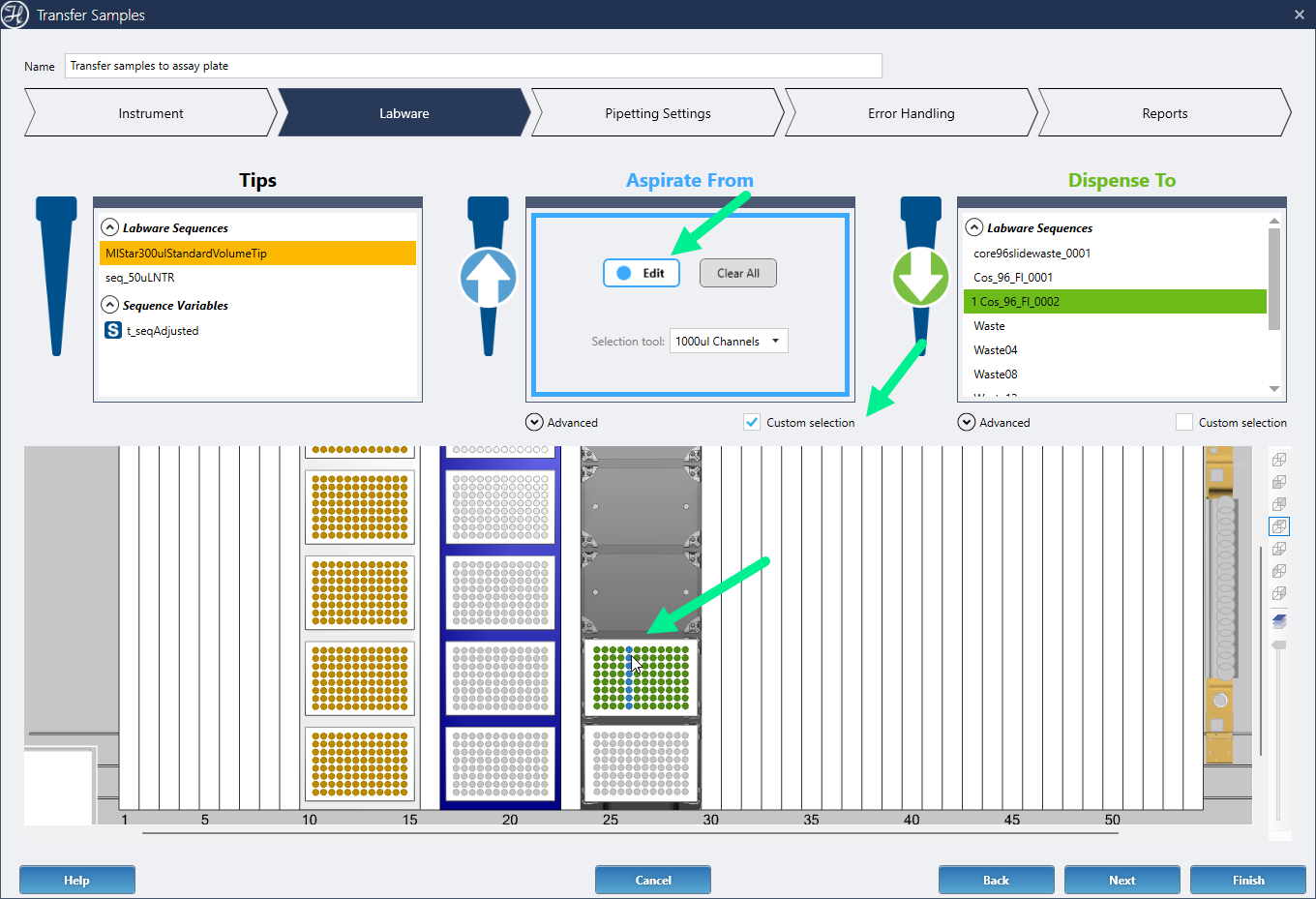

Now if you have VENUS 6, you can also do this in a PowerStep:
