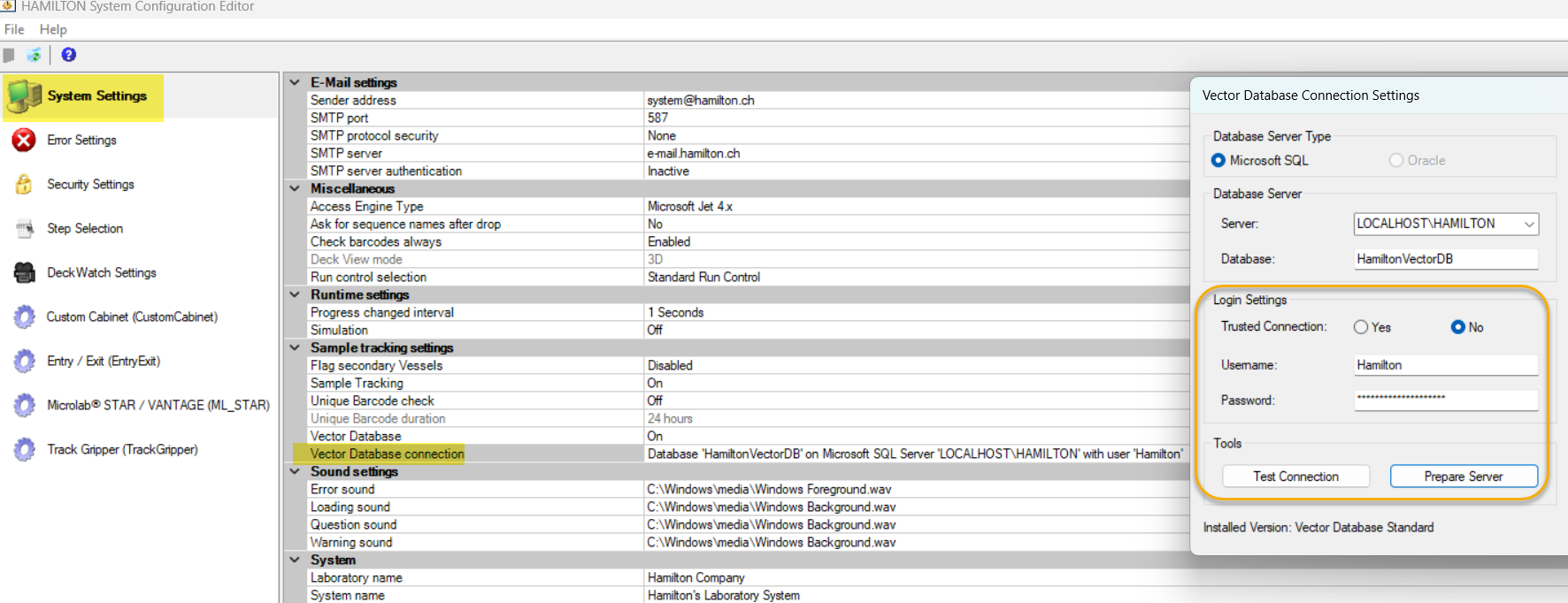

There can be several potential issues at play here so Ill provide a few suggestions. First, it looks like you are already using SQL authentication instead of Windows authentication for SQL server access. This is highly recommended, so just double check that your VectorDB connection settings have the following login configuration:

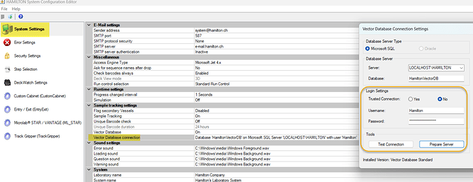

First thing I would check would be confirming that the default ‘Hamilton’ SQL account password hasn’t been modified in the connection configuration settings above. For 6.2.2, the installed password is:
P@ssWord:DB@^VENUS#6
Paste that in and select ‘Test Connection’. If it works, you should be good. If not, then you’ll need to check settings withing the Vector SQL server. If you haven’t already, you will need to download and install Microsoft SQL Server Management Studio.

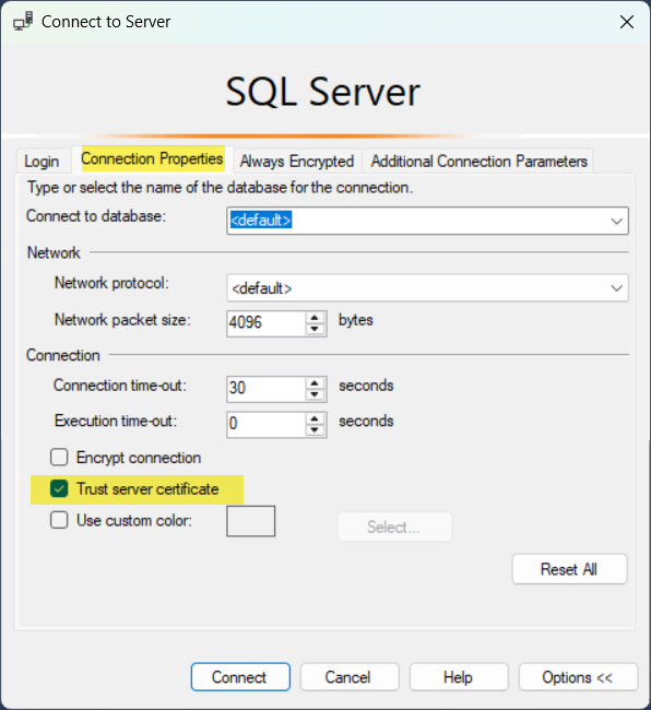

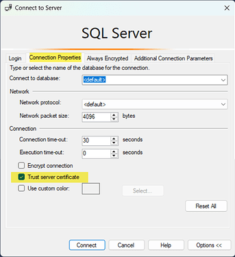

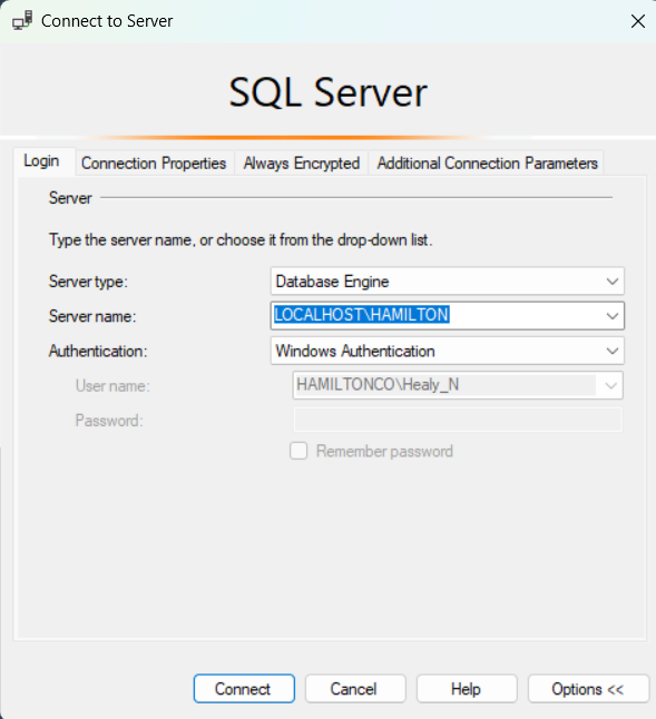

Once installed (using an administrator account) when you run SSMS you will be navigated to the SQL Server login page. Ensure you are set to the HAMILTON server name and using Windows Authentication.
Prior to logging in, select ‘Connection Properties’ and ensure ‘Trust server certificate’ is toggled on if it was not already. In some cases, this alone will solve your issue outright, but if not there are some other things to check once logging in.

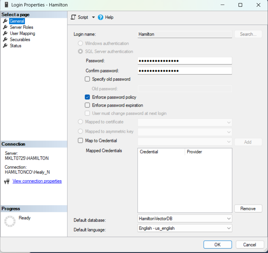

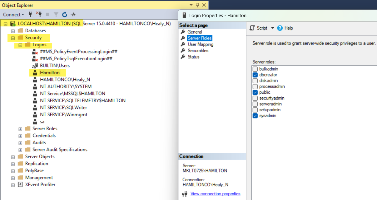

Navigate to the Hamilton account highlighted in the location below and open it’s properties. First I would ensure the server roles are set to the ones checked below.
While it is unlikely that the default Hamilton SQL account password does not mee the requirements of your companies password policy, you can also uncheck that setting if you believe it to be applicable. For future reference, this is where you can change the password used for the ‘Hamilton’ SQL account used by run control. If you change it here, then you will need to update the password in the VectorDB connection settings in system configuration editor.

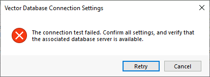

I’ve confirmed that my Vector Database Connection Settings match yours. I can’t verify that the password isn’t changed as it’s hidden, but if I over-type it with the password you give and test the connection I get the following error.

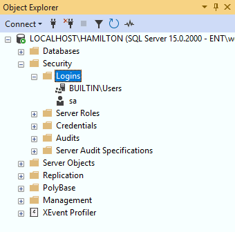

I installed SSMS as you suggested, ran it as a local admin, made sure that “Trust server certificate” was checked and connected to the local server. Worryingly, there seem to be quite a few entries under “Logins” that are missing.

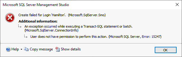

I imagine this wouldn’t be the best way to fix the issue anyway, but I tried to add the “Hamilton” user with details matching your screenshot. However, I am given the below error.

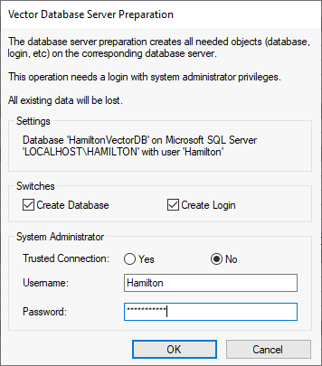

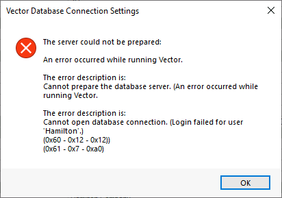

I tried going back to Vector Database Connection Settings and selected “Prepare Server” in an attempt to re-create the server. I entered the username “Hamilton” and the password you provided.
However, this produces the below error.

Hi Will,
I’m wondering if the underlying issue is that the Windows user account that installed VENUS either didn’t install as administrator, or didn’t have administrator rights to begin with.
Microsoft SQL Server 2019 is an independent software component outside of the core VENUS environment, and will not require VENUS to be uninstalled reinstalled. SQL Server can be reinstalled independently so long as afterwards, the VENUS installation is configured to use an authorized SQL user account created during manual SQL Server installation.
Before resorting to that, lets try one last thing. Seeing as the ‘sa’ account (system administrator) is present, try using ‘sa’ as the user. This account has elevated database credentials compared to the default ‘Hamilton’ account. The same password applies:
sa
DB@^VENUS#6
These credentials can also be used to reprepare the database.

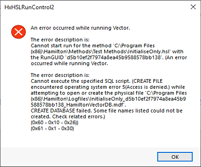

However, I still can’t run methods. Trying to run a method containing only an initialize and user dialog step gives me the following error.
This error seems to indicate that it isn’t possible to create the .mdf and probably .ldf files in the log file folder. On this system HxRun.exe is elevated to local administrator whilst running and local administrators have “Full Control” permissions over the log file folder and so I don’t understand why this is happening. Indeed, HxRun.exe is able to create a .trc file in the log file folder for these errored runs. This is what leads me to wonder if there is another executable involved in creating the .mdf and .ldf files that also needs to be elevated to local admin. If I change the permission for “BUILTIN\Users” from “Read & Execute” to “Modify” the error goes away and the method runs without an issue. The .ldf and .mdf files are successfully created.

HxRun.exe isn’t the software component that writes the SQL server database transaction logs and backup files to the Logfiles folder - it generates run traces, communication traces, run liquid databases (TADM data) and other supporting files.

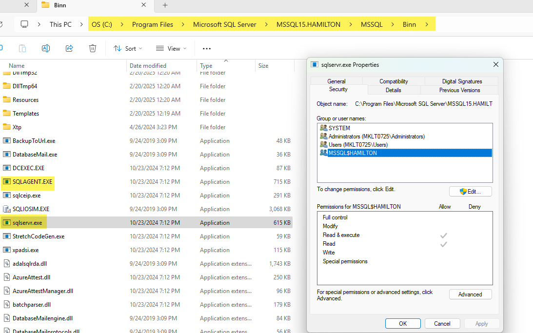

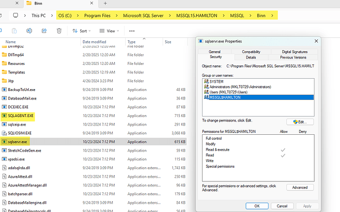

The SQL server log files are generated by the Hamilton SQL server Windows service(s) that runs alongside run control when Vector database features are toggled to be active. I suspect you will need to elevate the security privileges of these services to the same level you promoted HxRun.exe in order for all required Logfiles logs to be generated as required by software.
I would navigate to the location highlighted below and modify the security permissions of the two indicates Hamilton SQL server service exe’s.
Hopefully this does the trick. Thanks.

C:\Program Files\Microsoft SQL Server\MSSQL15.HAMILTON\MSSQL\Binn\SQLAGENT.EXE
C:\Program Files\Microsoft SQL Server\MSSQL15.HAMILTON\MSSQL\Binn\sqlservr.exe
