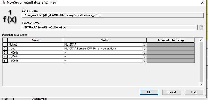

Hi @EricSindelar_Hamilton for the virtual labware library that you link to here, where is x=0 and y=0? Is it in the right hand, bottom corner? If I wanted the labware to shift in the direction towards 0,0, would my x and y in this instance be a negative number?
Hi Christina,
Itās relative to the labwareās current location, not relative to the systemās 0,0,0 origin.

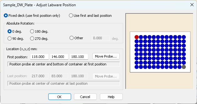

So if you have the following labwareās coordinates set as:
And then you used the VirtualLabware command above with 9mm increase in X and Y, then the X coordinate would be shifted to 127.00 and 155.00.
I hope that helps!
Eric
Great, thanks for the quick answer and that makes perfect sense. I think the word āDeltaā was throwing me off in the i_xDelta, i_yDelta.
