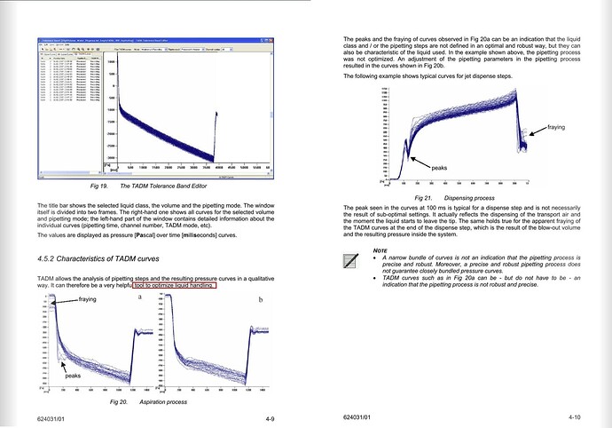

Is it remotely possible to use Hamiltons TADM readings for liquid class calibration?
TADM could be useful for precision assessment of your liquid class and pipetting parameters and then tuning consistency of transfers. Mainly checking to see if you are having issues pulling air or liquid when you don’t expect it. I don’t think it would be at all helpful for accuracy tuning.
Hamilton has a tool called Dynamic Liquid Classification that uses TADM data to compare an unknown liquid transfer to a collection of known transfers. Unfortunately, as I understand it, there is a patent on this methodology that prevents us from selling it stateside.

Any updates on this tool in 2024? Is it being used/sold in the US?
It is not available for sale in the US.
