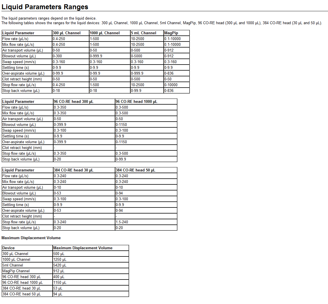

As far as parameter ranges, look in the C→Program Files x 86→ Hamilton →Bin Folder, and look for a file labeled “HxCoreLiquidEditorEnu.chm” . Navigate to the “Liquid Class Properties”→”Liquid Parameters Ranges” subsection. This lists all the liquid parameters for all the various channel sizes and channel types for your given version of Venus.
Screenshot of Venus 6.01.50042 seen below to help others in the future:
