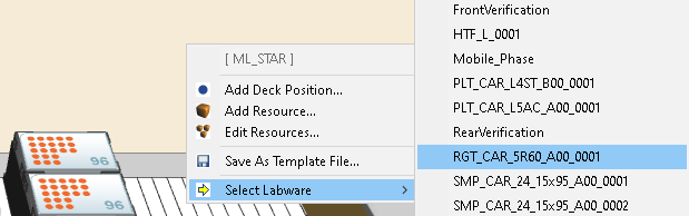

I am encountering a bug with the Deck Layout Editor. I am unable to select desired labware that are stacked on each other. I’ve tried sending the undesired labware backwards, but still unable to select it. Is this a known bug?
Hi Hoai,
In 3D mode, if you right-click anywhere off-deck, you can select Select Labware, which shows a list of all labware on the deck. Select the labware you want and it will highlight it and from there you can adjust it.
I’m seeing issues with the send to forward/back functions though in 2D mode so I will follow up internally.
That works. Thanks Eric. I was using 2D before.

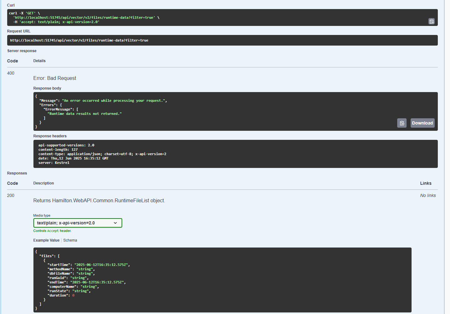

thank you for very fast response. I did some testing with the Rest API. It worked fine so far. I used “Put api/v1/vector/execution/input” to set variables in Venus. That worked great. Now my questions.
  1. Is there a possibilty to read variable values during or after the run ?
  2. I tried “Get api/v1/vector/file-management/runtime-data” with boolan switch false. But I always get “Runtime data results not returned.” The idea was to get the runGuid which I need in “Get api/v1/vector/file-management/trace-file”
    Thank you very much and best regards
    Wolfgang

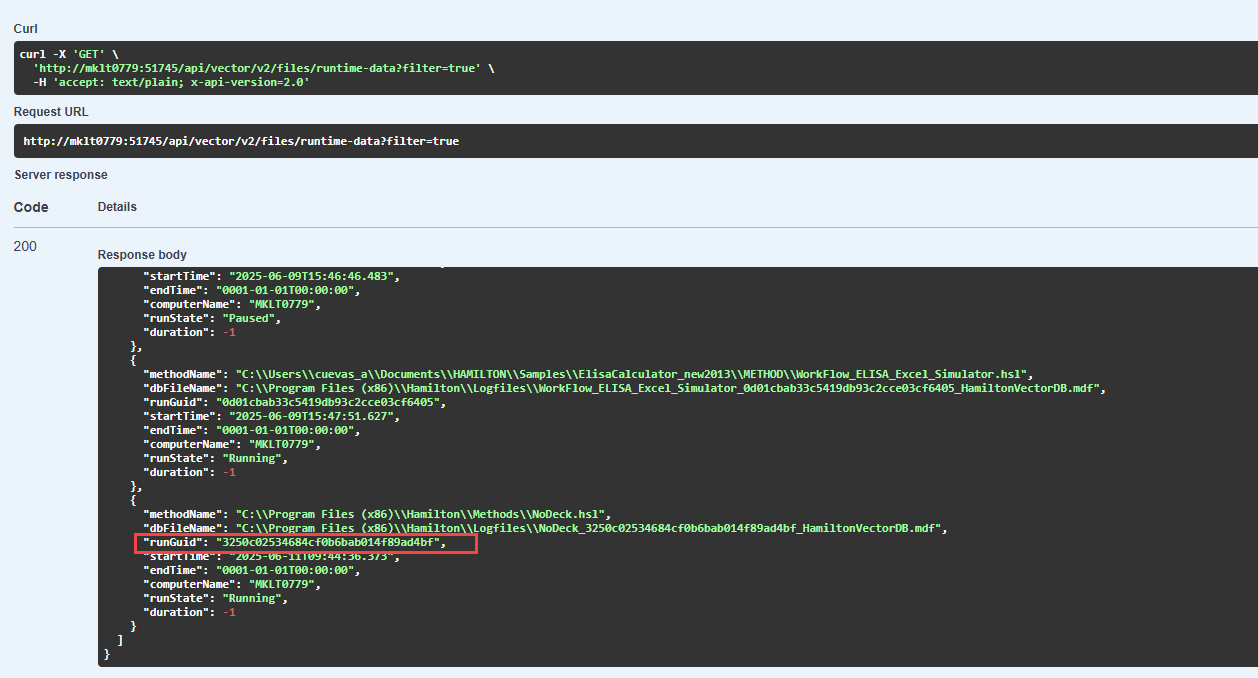

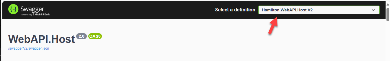

Hi Wolfgang,

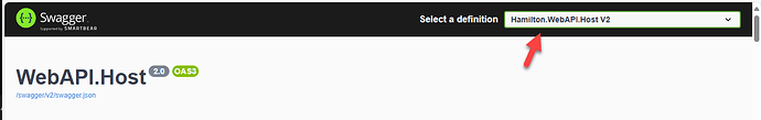

if running VENUS 6.2 or higher, it´s recommended to use v2 of the API, check the selector on the top right of the Swagger UI:
  1. There is currently no built-in API function to GET method variables at runtime, but the method could be written to have a parallel function running at all times to listen for new requests (either with cURL or using the custom HTTP library) from your controlling software and send back any requested variable information.

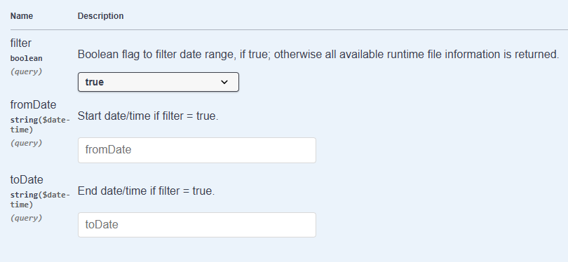

  2. To get the runGUID, once the run has started call /api/vector/v2/files/runtime-data
The last entry will be the current run, including its runGUID.
You can set a custom date range filter when calling runtime-data:
Alvaro

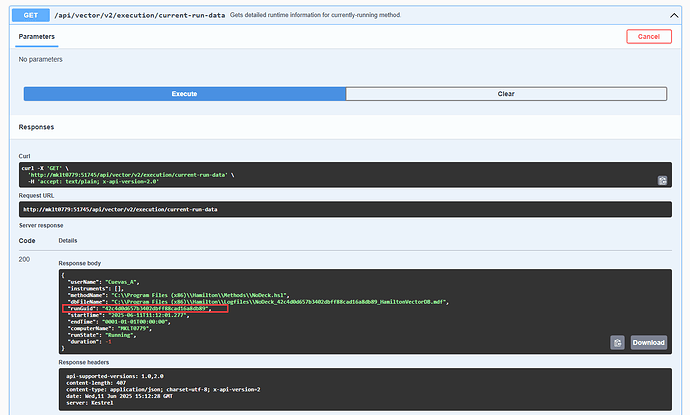

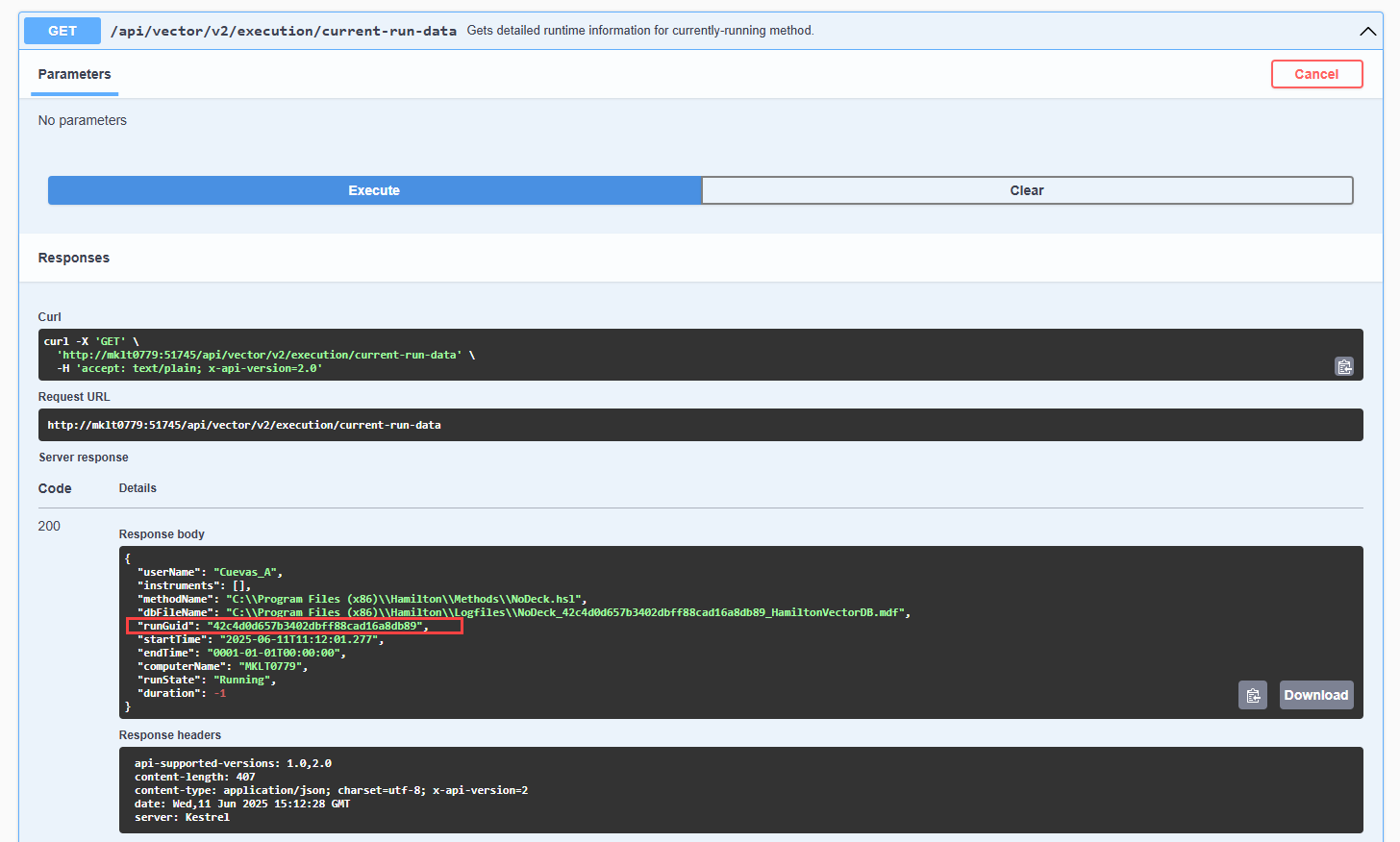

In 6.2, you can also call /api/vector/v2/execution/current-run-data
to get the run GUID:
Hi Alvaro,
that is my problem. I have selected WebAPIHost V2. I have a methde running.
I used the call /api/vector/v2/files/runtime-data
But I get no response with data. What I observed is, that the time in the response ist 2 hours wrong. That means made the call 18:35:12
Do you have an idea?
Best regards
Wolfgang

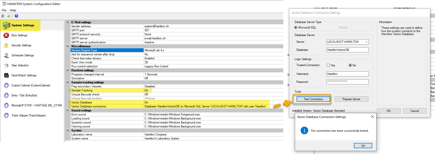

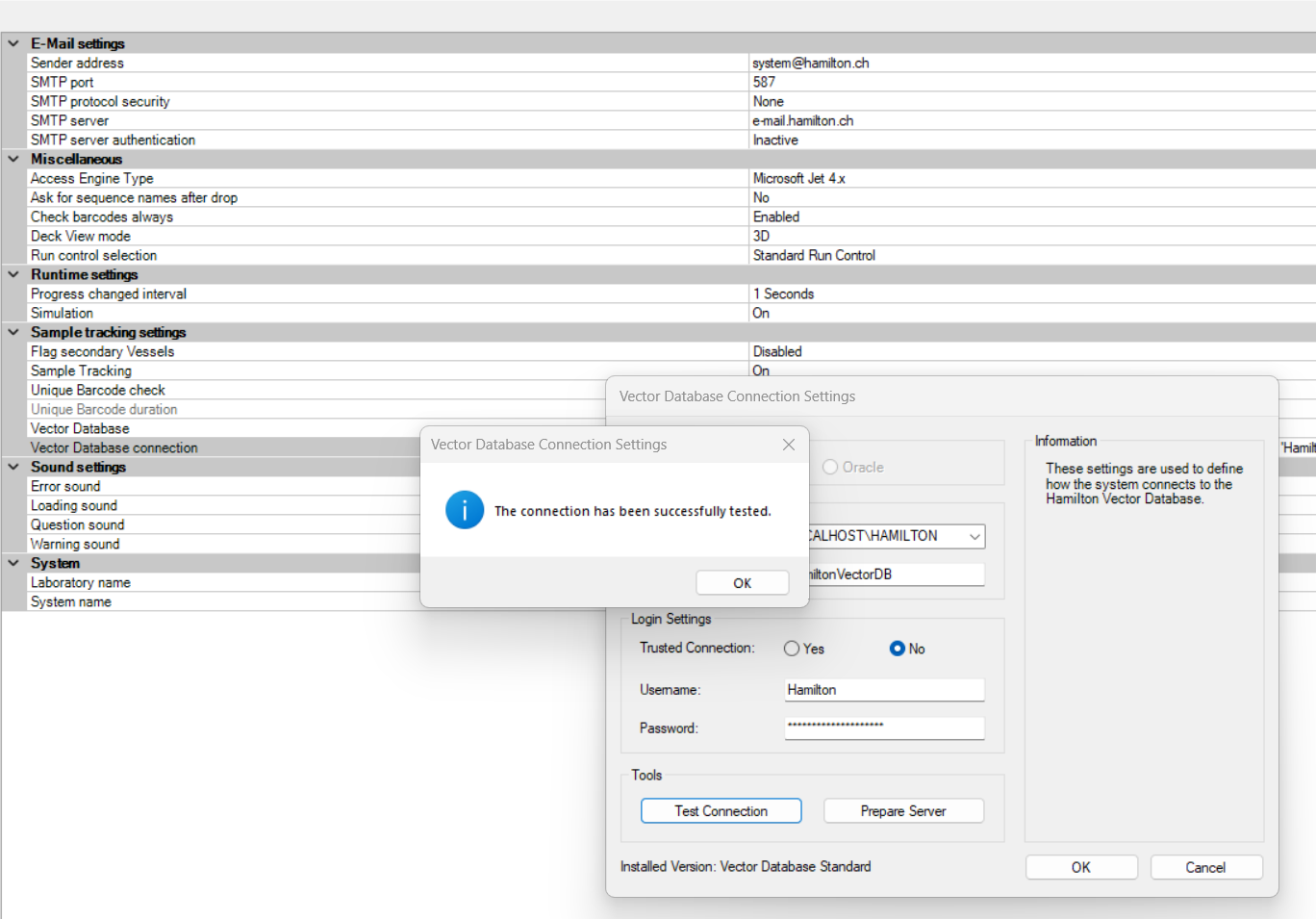

Hi Wolfgang,

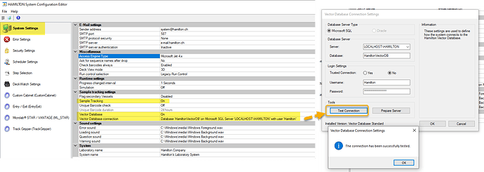

Can you confirm that you have sample tracking enabled and a functional SQL server Vector database instance?
The runtime data functionality you are attempting to use requires the Vector database to be active during runs. You can check these settings in the system configuration editor:
Thanks.
Yes

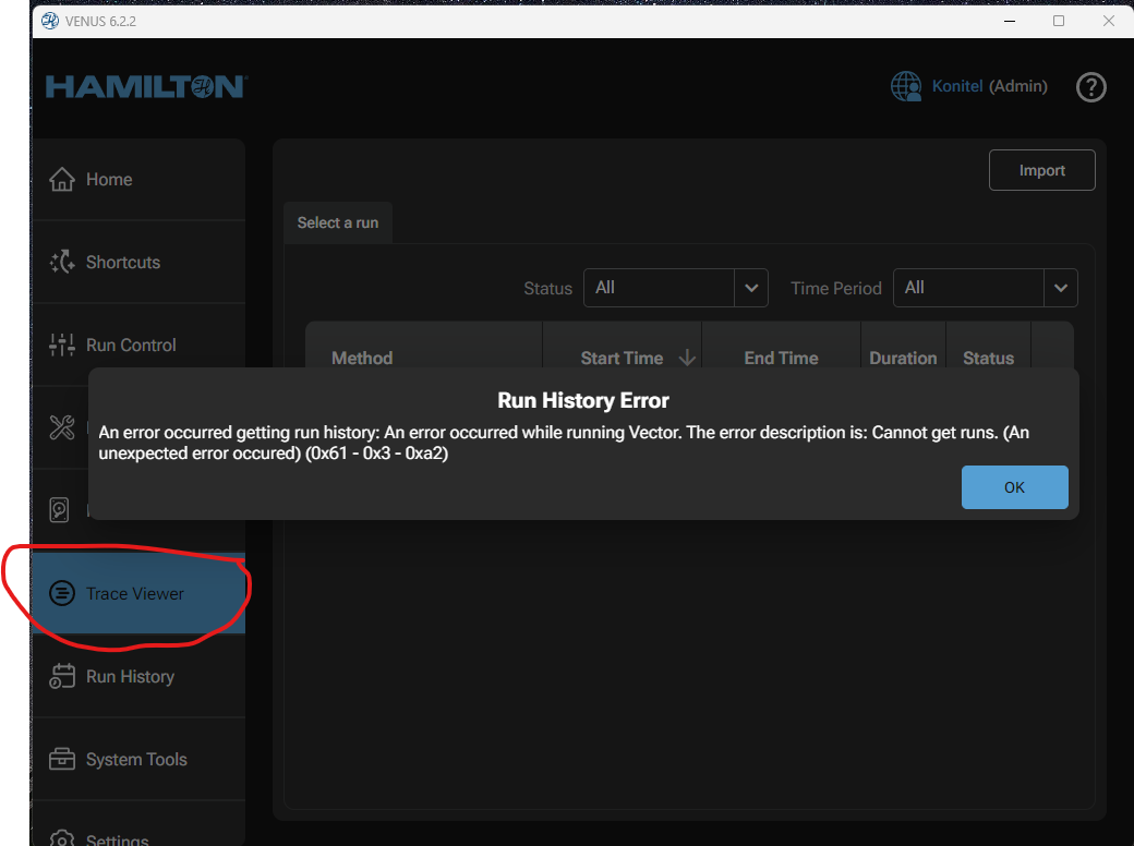

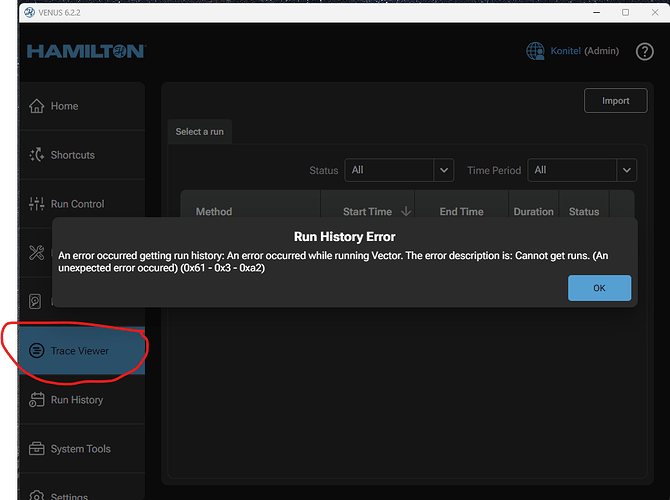

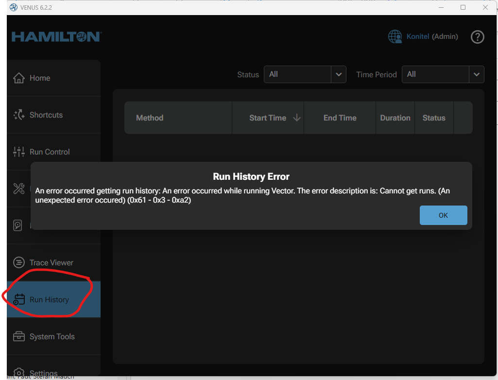

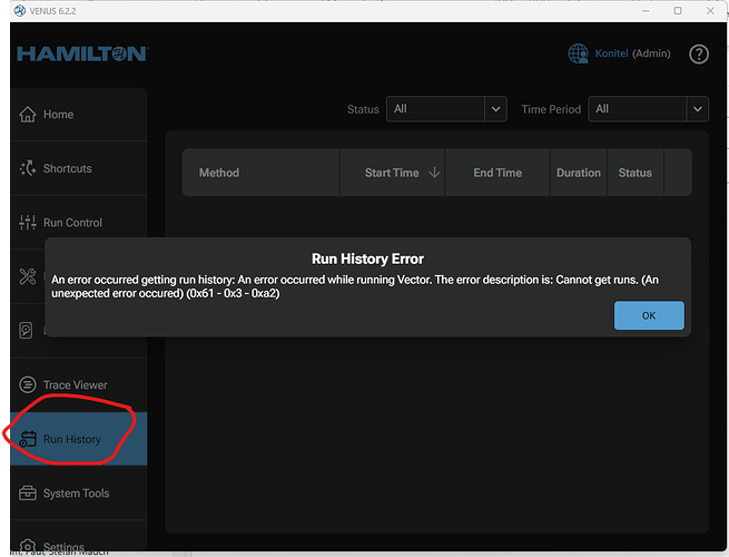

I found the problem. It’s related to my Venus installation. On my notebook, Trace Viewer and Run History show an error message. On an installation where Trace Viewer and Run History work, the REST API also works perfectly. Sorry to bother you with this problem.
