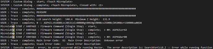

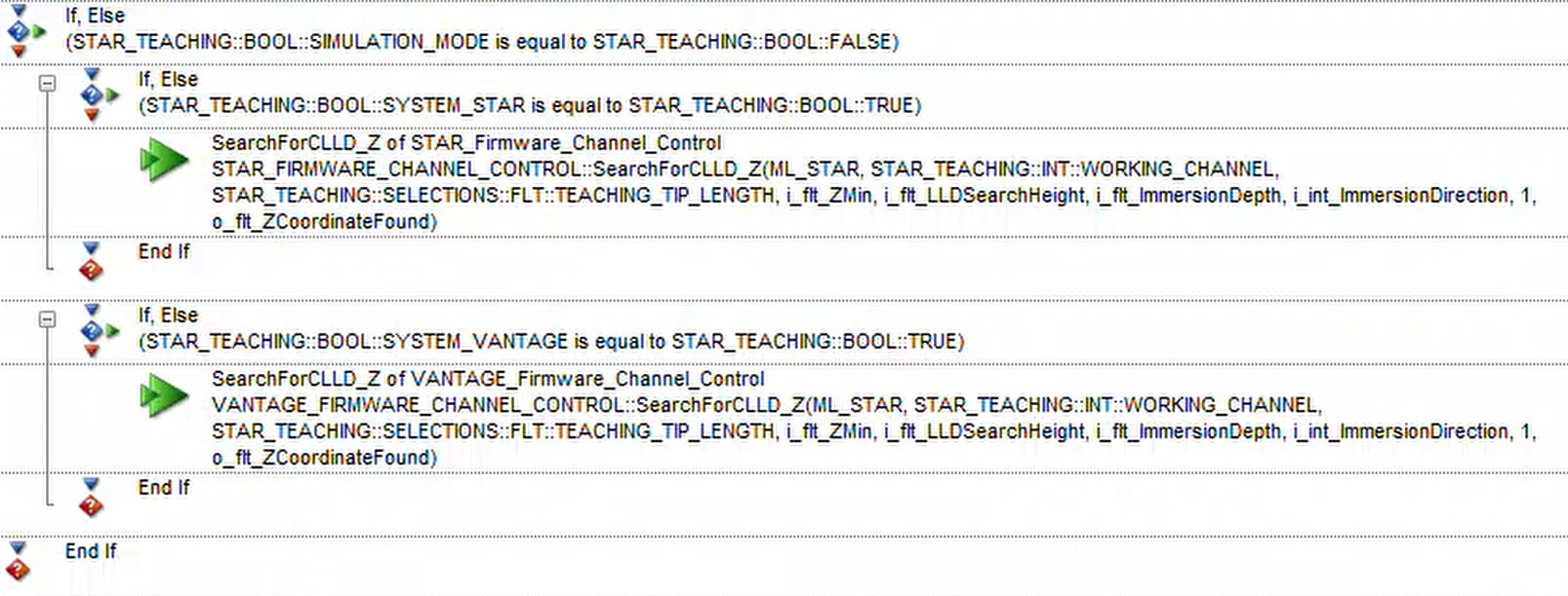

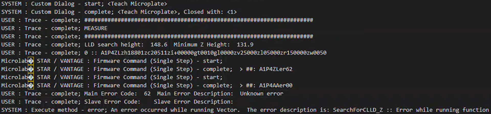

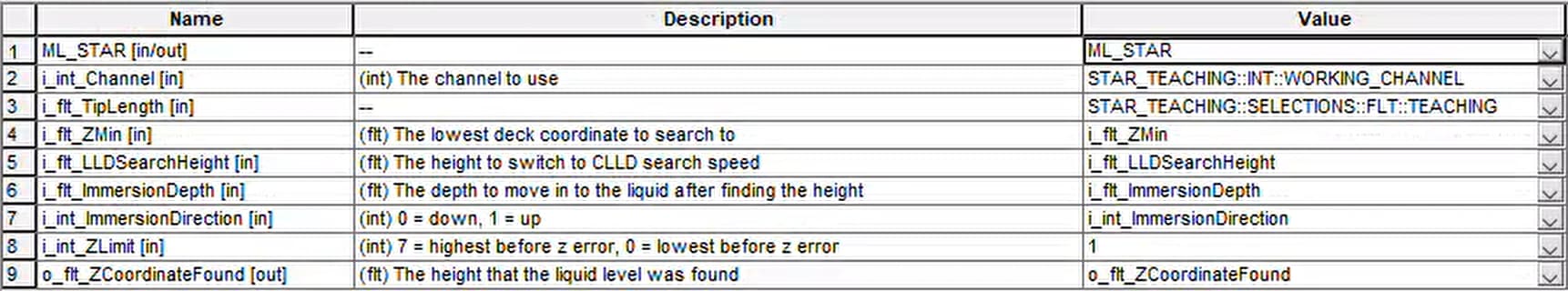

We are trying to use the ALC to automatically train liquid heights for volumes <10uL but run into Main Error Code: 62 when adjusting i_int_ZLimit in the SearchForCLLD_Z function. Default value is set to 3. Setting to 1 gives Main Error Code: 70 which is cLLD related, however setting the value to 0 gives us a new code that we have not seen before.
Pictures attached below for reference. Thank you!

Error 62 is a Z step loss error. Setting the i_int_ZLimit parameter only affects the amount of pushback the channels allow. Setting it to 0 on Vantage basically set this to the most sensitive level so the base tension of the channel likely threw the step loss. I would recommend not tweaking anything in the ALC method otherwise you risk damaging your channels.
Unless the labware is a PCR plate and is sitting on the 96 well PCR module, you are likely not going to be able to define heights for volumes < 10uL. For that method, 10uL is likely the lower limit depending on the labware in question.
The error 70 (No liquid level found) is already an indication that the volume is below the detection level for the teaching needle.

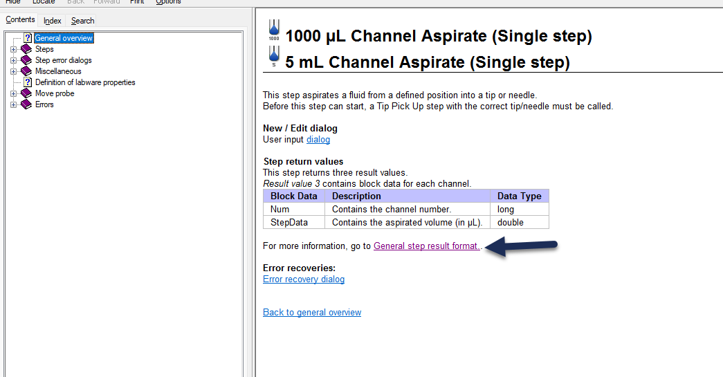

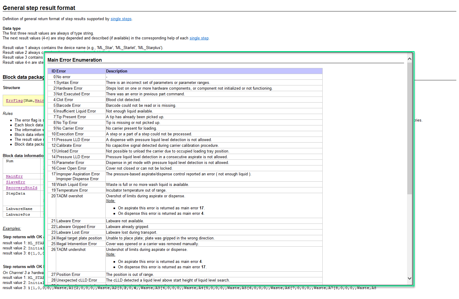

If you right click on any of the ML_STAR step commands and select What’s this? it will open the help menu for that command.
From there you can click on the General step result format… link.

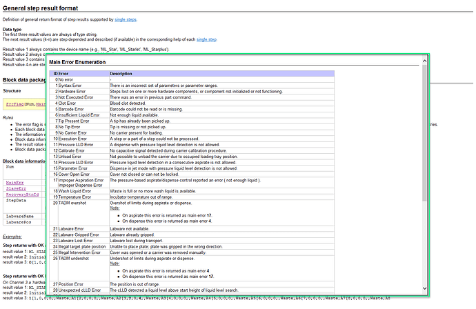

In that page click on the MainErr link to open up a list of all the Main errors.
These are the error codes that you are going to encounter with normal operation of your system and should match the descriptions that the error handling dialog shows.
Thanks - that is very informative! Are you able to provide a similar list with a description of the “SlaveErr” codes?
Hi @HenningGramHansen,
Here is a list of STARline error codes: STARline Errors.xlsx :: Hamilton
