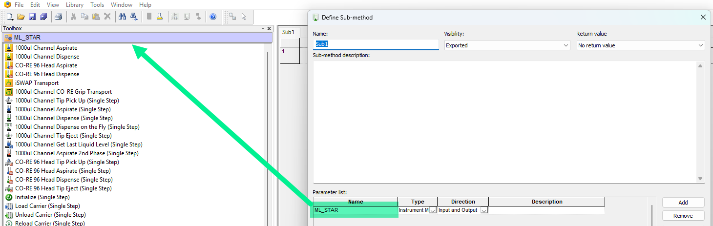

Is it possible to remove the ML_STAR device from an smt library? I want to set up a sub-method that takes the ML_STAR device as an argument. I copied and pasted some steps that referenced the device and Method Editor added the ML_STAR device to the toolbox tree. Even after reconfiguring the steps to use an argument, I don’t see any way to remove the device from the library.

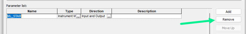

When this is referenced, then that function in the SMT will display the ML_STAR (name can be whatever you name it) toolbox that contains aspirate, dispense, etc. The ML_STAR device is tied to the ML_STAR functions.
To remove it, you need to edit the function parameters and remove the ML_STAR device reference.

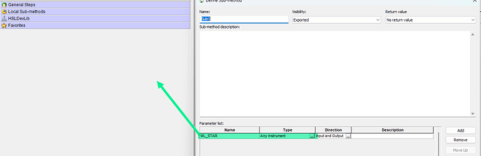

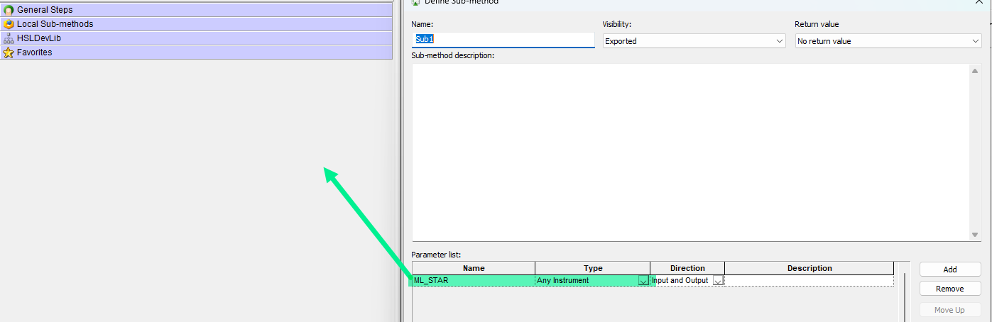

Another option that can be used is to reference Any Instrument as the type. This will accept any device level object (ML_STAR, TrackGripper, Nimbus, etc) but will not add the ML_STAR Toolbox functions.
Thanks @BrandonBare_Hamilton!
My function did reference ML_STAR as a parameter which was set to Instrument Microlab STAR. Changing it to Any Instrument does remove ML_STAR from the toolbox, and maintains the ML_STAR parameter within the function. This is what I was looking for.
