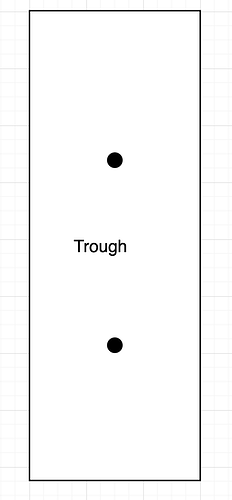

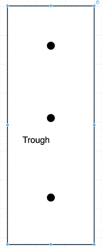

they should be wrt this:
(n=2)
(n=3)
etc

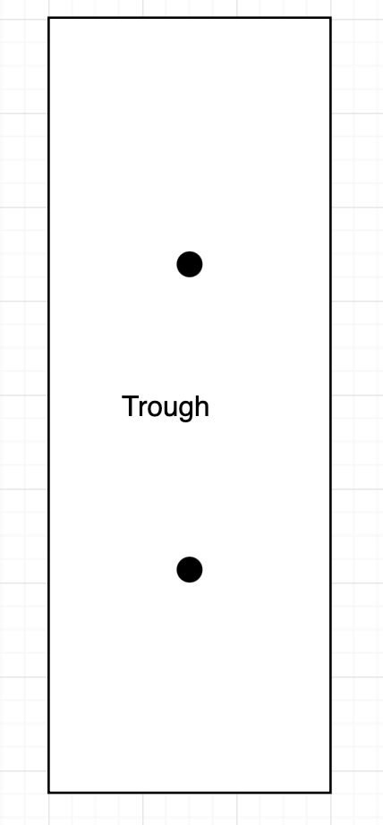

Thank you for the nice visuals.
This is what happens when not given an offset argument, but when given the spacing appears roughly doubled?
Here you can also see very nicely how odd channel numbers will crash the central tip into the anti-splash wall of the trough.
