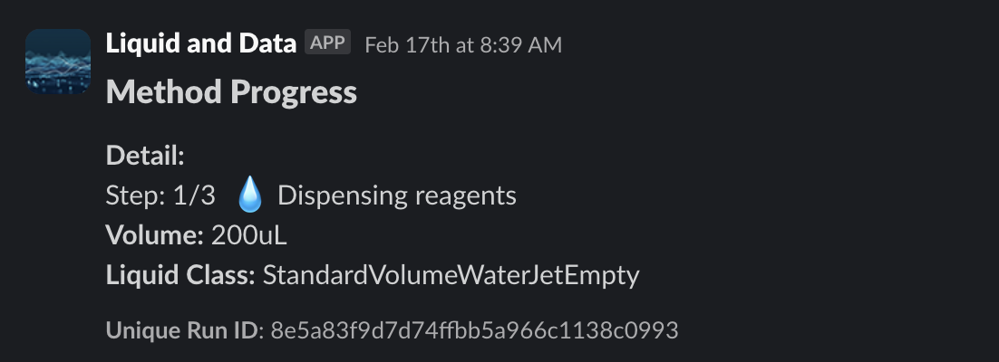

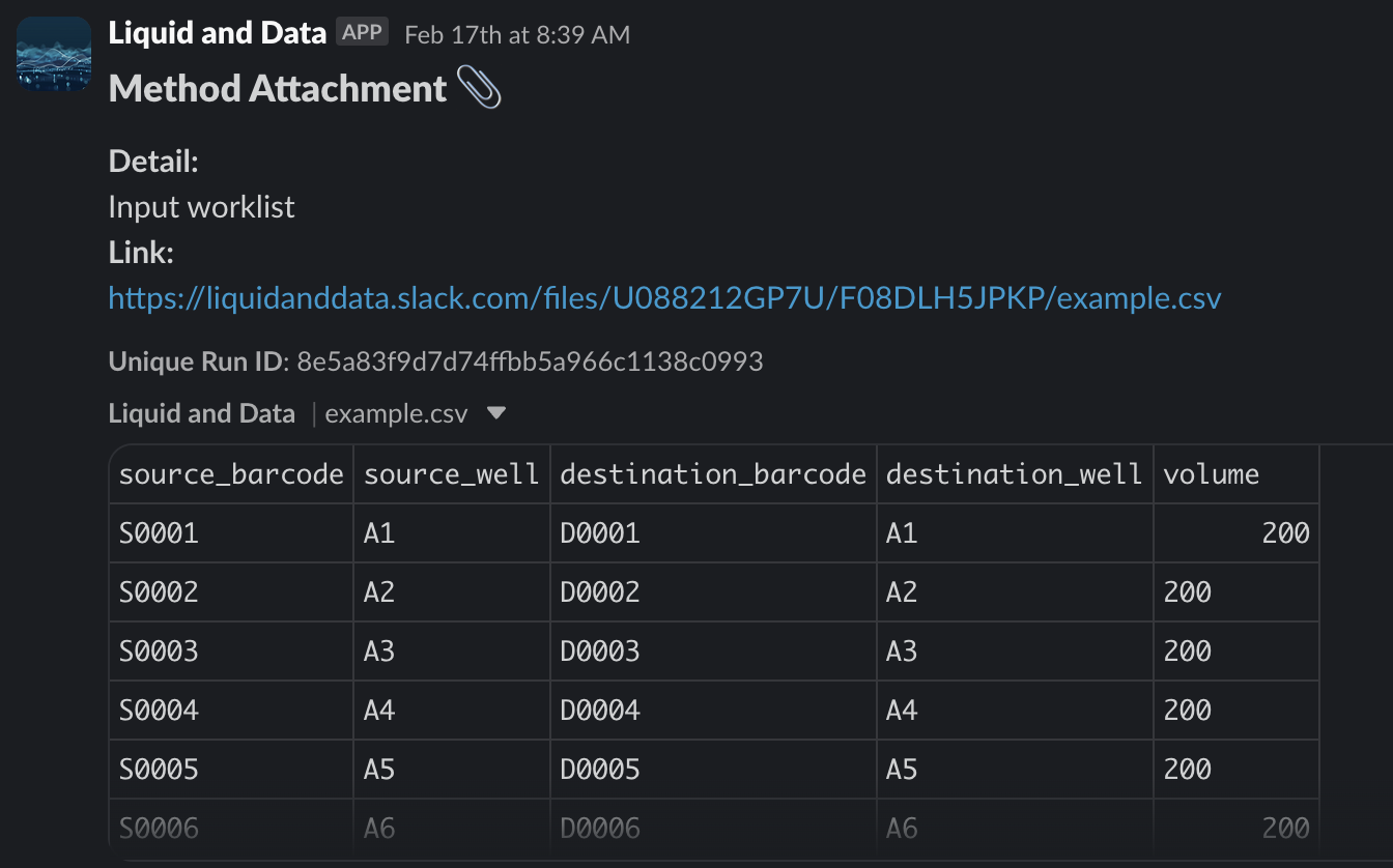

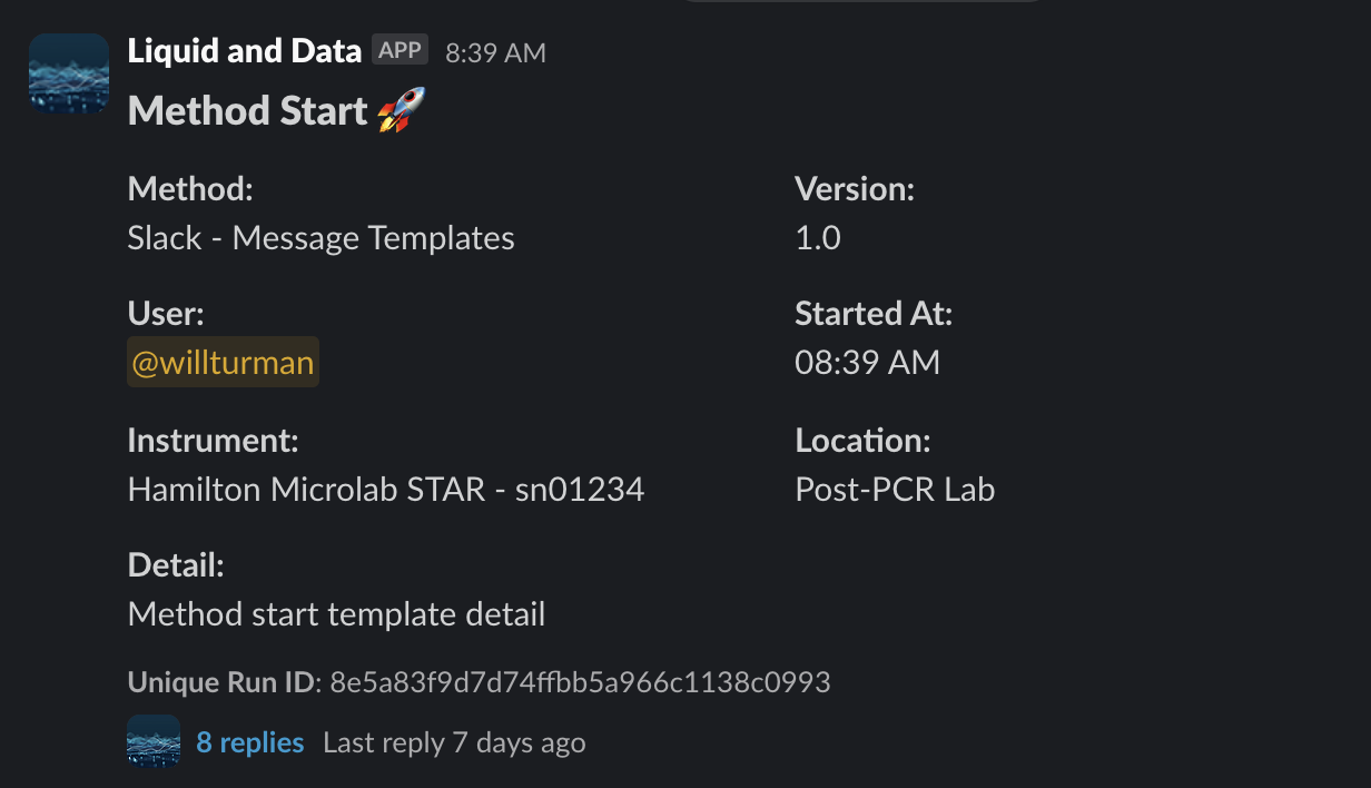

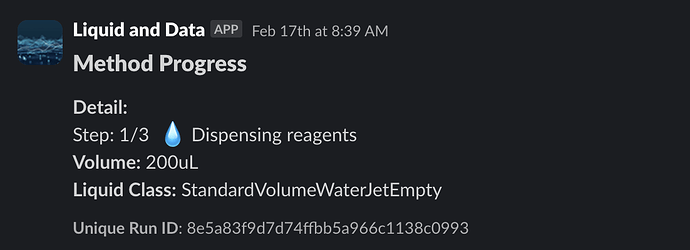

I’ve released a Venus library to integrate your Hamilton robots with Slack.
I essentially built this out to include nearly everything I’d want in a Slack integration from a development, troubleshooting, operations, and fleet visibility perspective and would love to hear what your think.

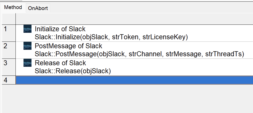

Sending a basic message to Slack takes three commands:

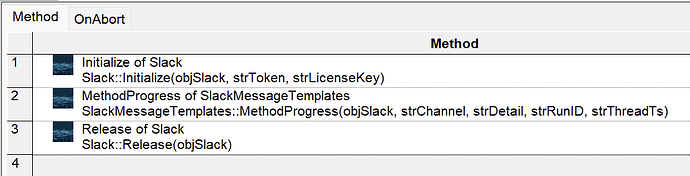

Sending a formatted message takes three commands using the included sub-method template library:
Uploading files directly to channels or linking them and having them unfurled in threads is supported as well:
Threaded messages are supported to keep information organized:

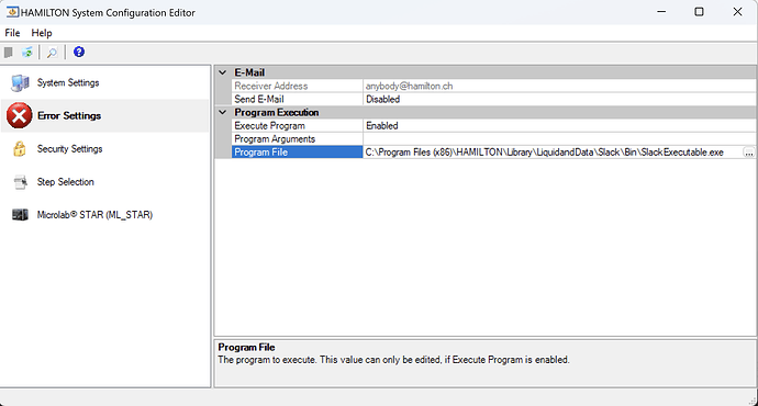

An executable to post dynamic content to Slack about those tricky to handle hardware errors (i.e. liquid not found, tip pickup errors) via the Hamilton hardware error reporting mechanism is included out-of-the-box:
Sending messages to channels, users, or group-dms is supported, as is tagging users for high-priority notifications.
There are any number of ways and tools to use to hit Slack’s API to post a message, or integrate notifications from liquid handlers - I’m thinking about this as an integration that enables you to bring timely, relevant information from your automation into a workspace you’re already using using tools you’re familiar with.
