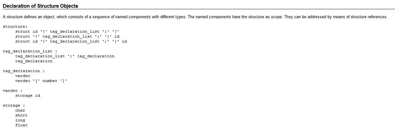

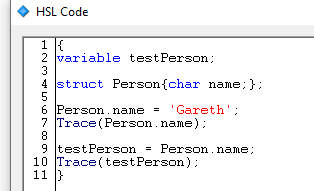

Hi @Gareth,
See below for the three options for declaring your example structure. The Help file image you posted is a bit confusing, but what it is trying to get across is that the structure id can be either leading, trailing, or both. In the case of both, the ids need to match.

Hi @Gareth,
I’ve not seen the structure object used in any of the HSL files I’ve dug through in the past. This is likely due to limited use cases stemming from limited functionality offered by the structure object itself.
The first curly bracket in my image is there because I tested the code as in-line HSL in VENUS Method Editor, which requires open/close brackets when declaring objects, as those objects are made local to that in-line code block.
As for the remainder of your code, see below for the required modifications:
This code traces the integer 71 (decimal ASCII for uppercase G). Note the single quotes around ‘Gareth’ as char is not a string, but is able to store the first character as an integer value. The default library, HSLStrLib, has a command for converting ASCII decimal to string values.
The code here allows assignment of the ‘name’ tag declaration to variable ‘testPerson’:
Both traces yield 71 in this case, too.

Thanks Stefan. The screenshot I posted was from there, some of the documentation in there is a bit sparse however.
