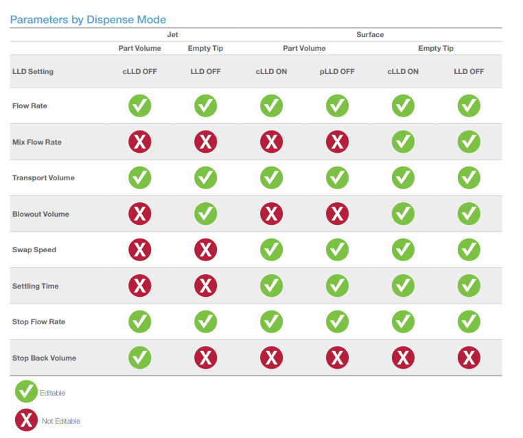

Jet and Surface inherently can not have the same parameters. If you look at the graph above, Jet dispense has a lot of blanked out settings that the firmware either manages itself or are not applicable. If you toggle the drop down between Jet and Surface when making the liquid class you will see these settings blank out.
Additionally, LLD is never on for jet dispense because ideally you are not touching the liquid in the well while dispensing. You’ll get a fun error if it is turned on so I guess that would also be a big firmware difference.
Christina’s guide is quite comprehensive, but to maybe answer your question directly: Jet and Surface (and Empty and Part) are not just filtering options, they set up a fundament for your liquid class that you won’t be able to deviate from.
The clearest example is mixing. You can not mix with a Jet liquid class, as it won’t touch the liquid on dispense by definition. If you try, you get a runtime error.

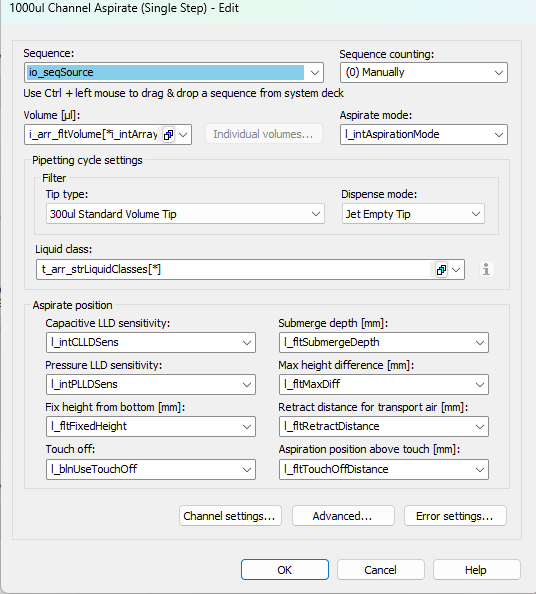

Hi @KevinJ if you are preparing your aspiration (or dispense) you should understand what you are basically doing.
In my screenshot above you see a default aspiration with channels. For MPH this might look a bit different but the philosophy is the same. However interestingly the liquidclass will also “tell” the liquid handler the tip on that channel. As you see in my screenshot the Liquid Class is coming from an array. But for the argument, if you put your liquidclass here. The tip type and modes are correctly taken over.
The screenshot from @Christina is the one you should try to memorize. It contains all the basic allowed settings and modes.

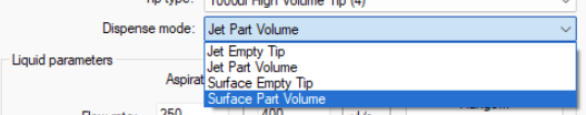

Try opening a dispense step and look closely at the settings. Dispense mode is also interesting.
