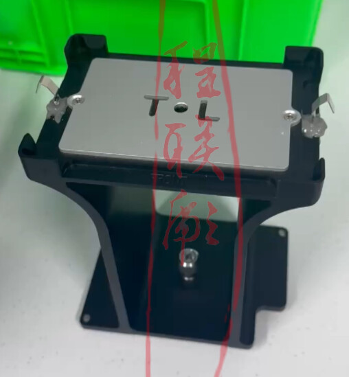

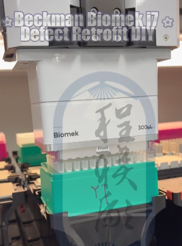

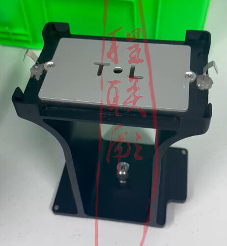

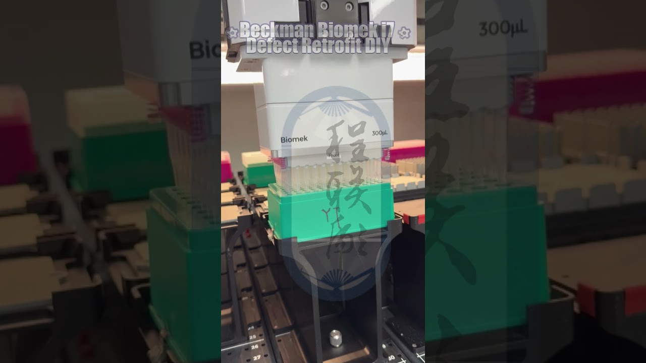

I have try some DIY to solve this problem. https://youtube.com/shorts/EIkM51ckS_M?si=lhzAfyi1Qj_1vzzn
Now I have change 96 head for avoid this error.
