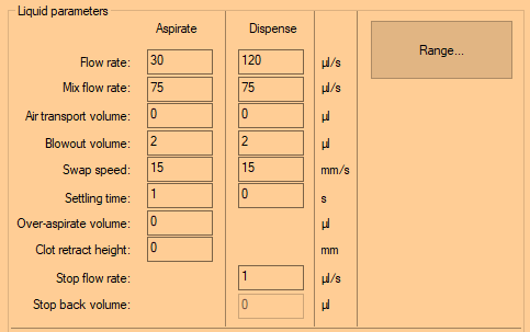

That’s my general rule, don’t go below 10% of the tip.
However if you must, there’s a lot of optimizations that should be performed but also assay optimizations to verify you’re okay if something is even slightly off.
Liquid class for aqueous transfers 1.0 < vol < 5.0.
Thanks for sharing that, just so that I know the full picture are you happy to share the other details of the transfer? Do you prime (i.e. pre-rinse/mix on aspirate) those aspirations? Do you mix on dispense to rinse out the tip? Is that used with a fixed height aspirate / dispense? With that 2uL blowout I assume you use ‘dispense remaining volume’ instead of a defined volume dispense? Is this surface dispense into dry wells or into liquid?
Sure.
  • We do not prime low volume transfers. We will only prime for volatile liquid (any volume) to minimize dripping.
  • Depends. If we are pipetting reagent into a liquid then yes we will mix to ensure a homogeneous solution. In the cases where we transfer 2uL to a stunner plate we do not mix because the solution is already homogeneous.
  • We track the volume of each well in our methods so every aspirate / dispense is at a known height. Typically we aspirate and dispense 2mm below the liquid level.
  • We’ve found it to work either with dispense remaining and dispense volume.
  • Stunner plate is a dry well. All other low volume transfers are always a surface dispense into a liquid if possible.
I do want to be clear this was a starting liquid class provided by Hamilton. We adjust it here and there depending on our solution composition.

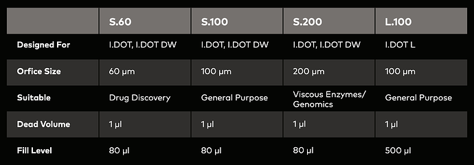

I’m happy to hear that you are interested in the DISPENDIX’s I.DOT, and I would like to share some perks of having one in your lab. The I.DOT liquid handler is designed for universal usability, accommodating users with varying levels of automation experience.
With the capability to dispense volumes ranging from 4nL to 30uL into any SBS format destination labware with exceptional precision, the I.DOT simplifies software operations for tasks like dispensing a constant volume, performing dilutions, normalizations, and pooling. Achieve a 1uL dead volume when dispensing reagents, allowing you to run more samples with the same reagent cost. Integrated volume verification provides insight into the actual volume dispensed in every operation. The instrument can dispense up to 384 source liquids per run, surprising you and your colleagues with its speed and precision daily.
If you want to know more, don’t hesitate to contact us! We’re more than happy to help you out.
