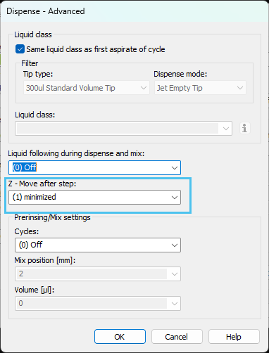

You could use the minimized Z-Move after step on the dispense and then use a second dispense step of 0 volume to perform the mixing. This will keep the tips within the container clearance height (this can be dialed in in the ctr file) instead of moving to traverse height in between dispense and mix.
