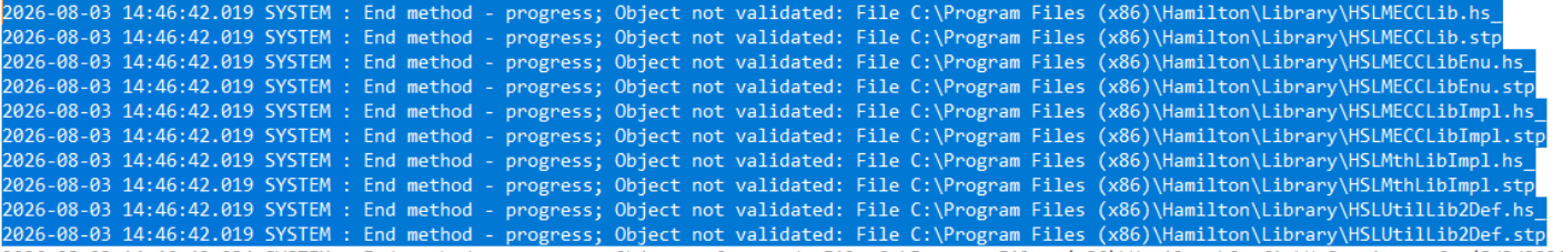

Hi, I upgraded my system to Venus 6.4 and am forgetting how to go about validating these types of files (.stp and hs_). I can’t open them in either method editor or hsl editor. Am I totally forgetting something here? On my Venus 4 install all files were appearing as validated.

for the hs_, my trick is to change the extension into hsl. Then, it opens and can be validated. I guess the same can be done for stp.
Not sure if it is the good way but it works for me.
Thanks Kevin, after reading your advice I was able to manually do an open with HSL Method Editor and that allowed me to open and validate them without changing the file extension
