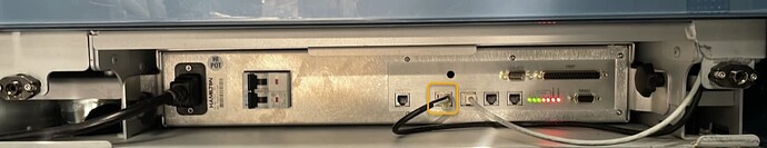

At this point I would confirm physical network and power connections are intact. If you remove the kickboard panel at the very bottom of the front of the cabinet, you’ll see what’s called a power socket drawer on one end of the system. Can you please take a photo and post the image here? It should look like this:
The highlighted network port should have a constant green LED on the left of the cable and a blinking orange LED on the right of the cable.

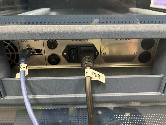

Thanks for your reply! This Vantage’s power and ethernet connection are on the side of the instrument. The network port through which the Vantage is connecting to the computer only has a green light, not a blinking orange. This is also true for the light of the corresponding network port on the computer itself.

The connections and ports in your image are for the gateway processor, which resides in an electronics compartment under the left most deck panels. This is the main entry point to the VANTAGE network, and is the primary processor which controls all pipettor components (arm, lights, loading tray, front cover lock, IDL etc).
For VANTAGE configurations extended to include additional components (custom cabinet with magnetic locks, track gripper, entry exit module, logistics cabinet), there is an additional separate processor unit tethered to the gateway called a power socket (shown in the original image from my first reply). This is a separate network endpoint within the VANTAGE system with its own IP:port address unique from the gateway but within the same subnet.
When you add a custom cabinet device to a method’s decklayout, during run analysis (onset of run when compiler checks and system device connections are made) run control will attempt to connect to a powersocket via the configured network settings (almost always 192.168.1.2:2000).
If the connections to the power socket are not intact, or the network settings are no longer correct, then you will experience the error you have reported here.
If you dont mind, check behind the little kickboard on the bottom front of the system, or please provide an image of the entire system and I can point you in the right direction.

Sorry for the confusion, I didn’t attach a picture from behind the kickboard because when I remove the board, nothing is there.
Our service engineer was last minute able to stop by and he pointed out that the cabinet we have with this instrument is literally just being used as a table, which I didn’t know was possible (or why it would even be desired…) and it is unlike the other Vantage/cabinet configurations we have onsite. So that would explain why there isn’t a power socket underneath the cabinet or anything for the system config to find to connect to. Thanks for taking the time to explain everything in detail, though, that was very helpful!
