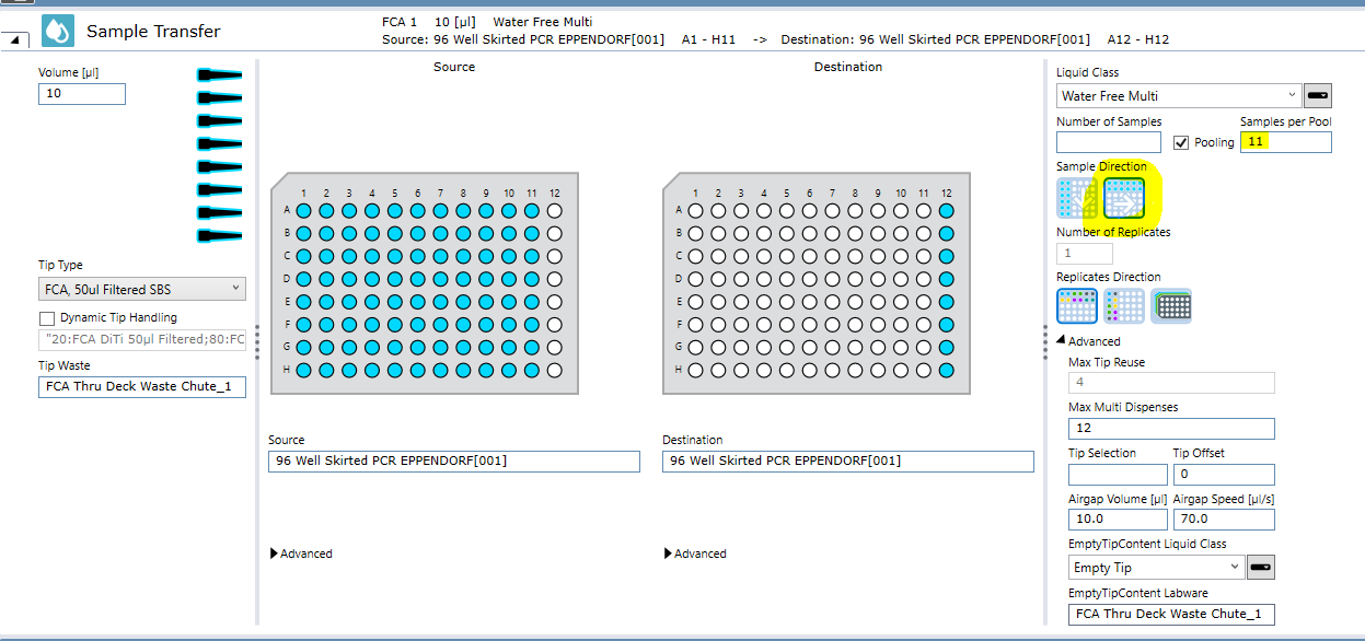

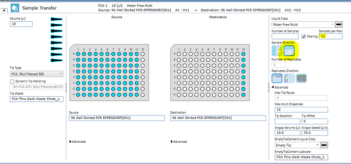

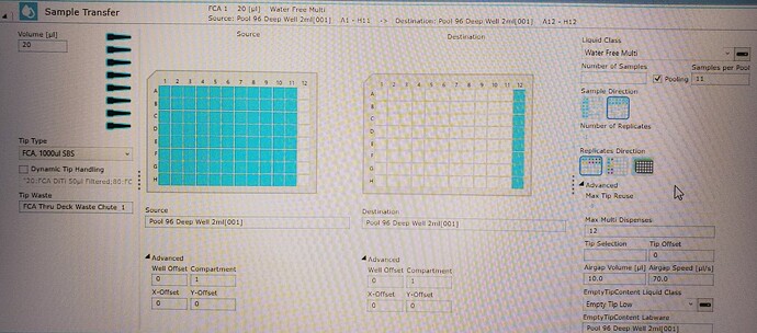

Pooling is available through the FCA “Sample Transfer” function. Note, I’m running FluentControl Ver. 3.7 software.
I will also specify that using a Worklist and a .CSV file gives you greater control. Depending on the labware source, generally a 96-well plate will have 96 positions. You can tell the FCA to do 1-to-1 transfers, however those would be processed individually. The Sample Transfer screenshot above would (likely) process with all 8 tips simultaneously, although I’m not in the lab to verify and running the simulator remotely is a waste of time.

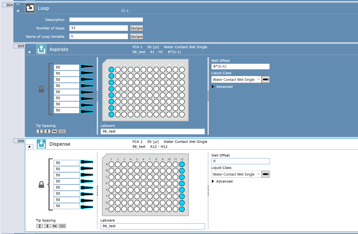

If you are using an older version of FC without the Sample Transfer command or would like to do something a little more custom, it’s also possible to use the well-offset field in Asp/Disp commands to accomplish the same thing.
To offset by a single column, you’d enter 8 into that field. In a loop, you can aspirate from column 1-11 into column 12 with something like this:
With this and the tip mask stuff, you can do pretty complicated things, but I find it to be pretty hard to maintain. Be careful with off by one errors, ha.

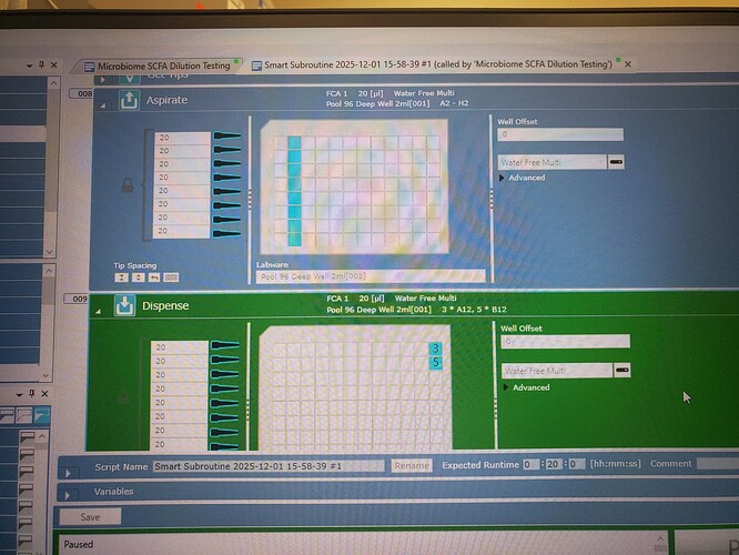

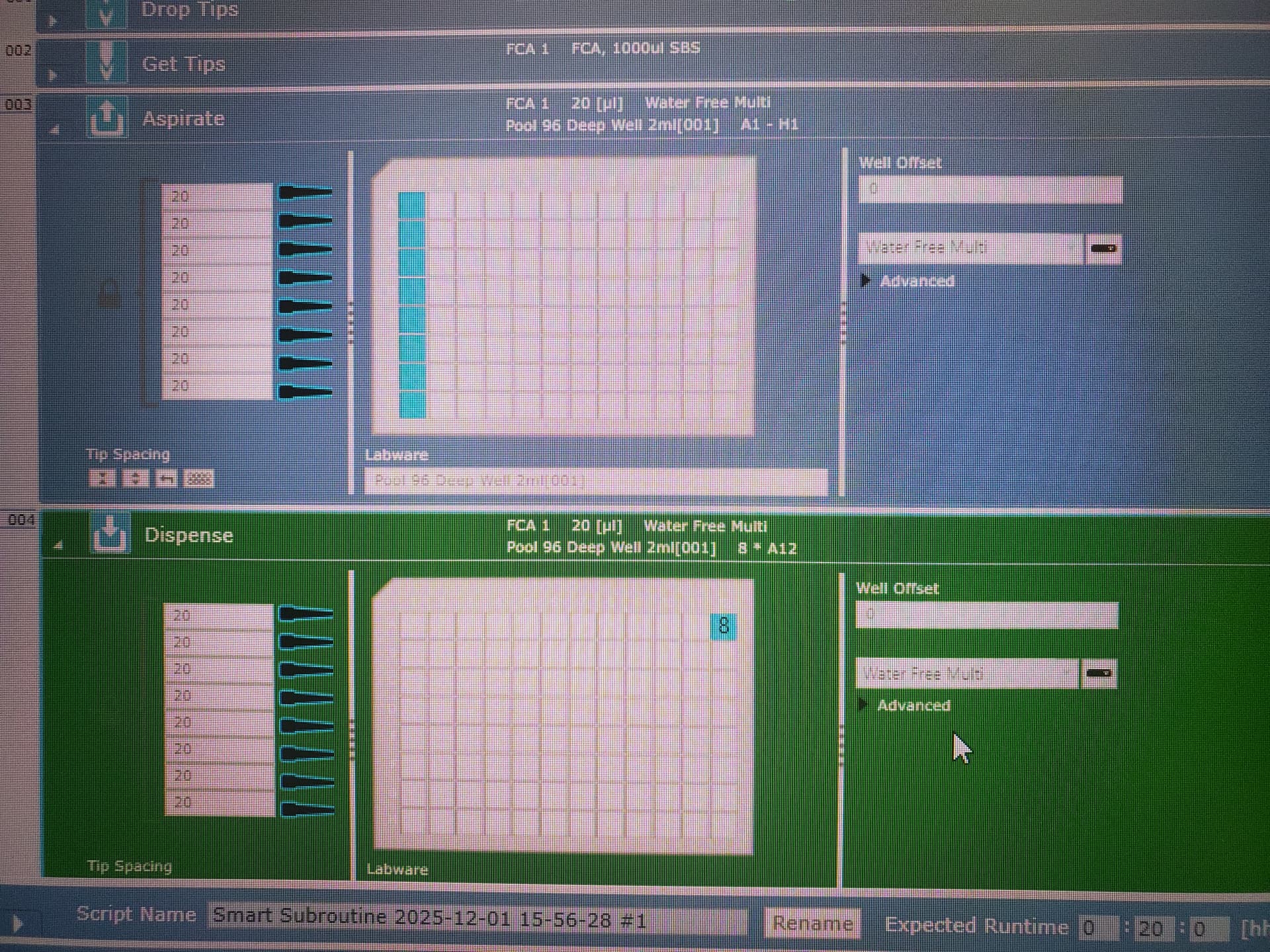

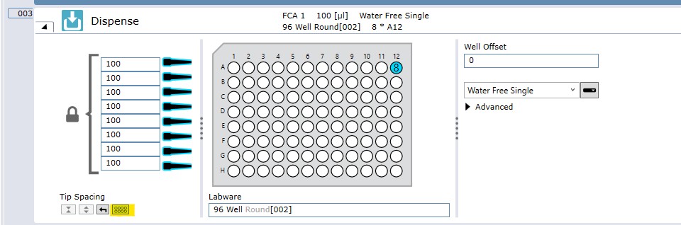

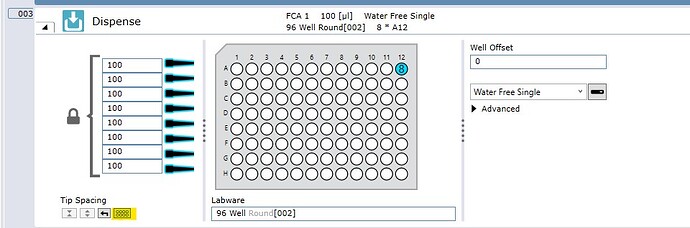

You can do pooling without the smart command using the traditional dispense command. Here I’ve got it doing 8 dispenses to well A12 of the plate per your use case. The key to this is using the (easy to overlook) tip spacing icon which I highlighted in the image. This should work across nearly all versions of FluentControl software.

This approach would work for pooling samples in a different circumstance, but doesnt seem to work in this case. Duplicating these settings on my end doesnt condense a row into a single well. When I tested the method and looked at the subroutine that gets generated, 11 wells are getting pooled into 1, but it still processes down columns instead of across the rows. I am also on FluentControl v3.7
This is what I had in mind for this instance, just didnt realize how the well offset field was being used. Thank You!

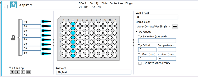

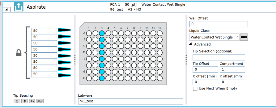

Your description says you want to condense across a row into a single well. So let’s take the first row, wells A1, A2, A3, A4, A5, A6, A7 and A8 and condense to A12. Your screenshot of the aspirate command has the 1st column selected. The FCA channels can only spread in the y-direction, not in the x-direction. So to go across wells you would want 8 individual aspirate commands, one for A1, one for A2, etc., then going to A12 with the 8 number on the well using the single dispense command like is shown in your screenshot. Then you would do a 2nd transfer to do wells A9, A10 and A11 to condense to A12.

well offset is the way to go
