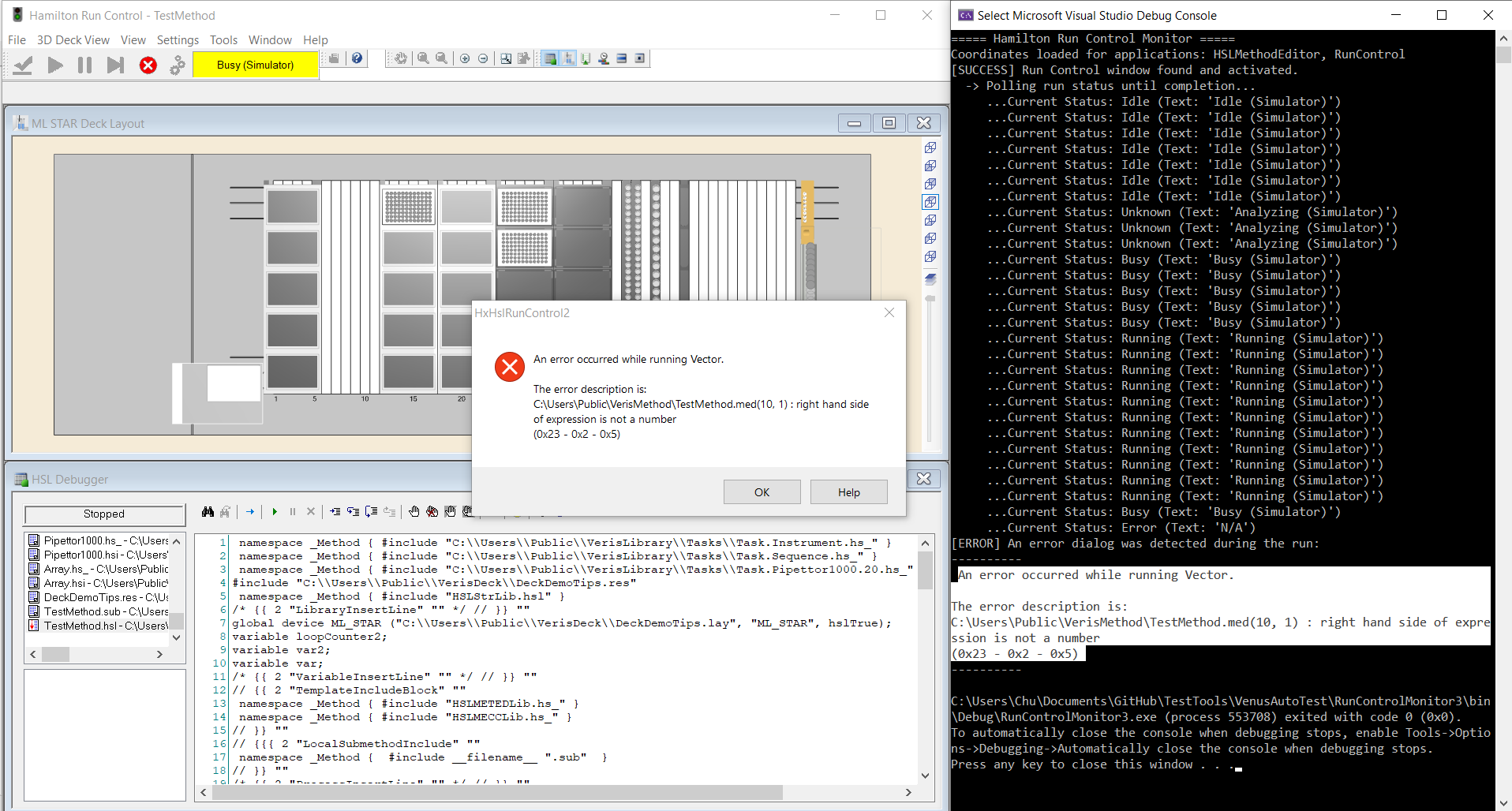

My current implementation polls the Hamilton Run Control status by using user32.dll functions (like FindWindow and GetWindowText) to retrieve text from its status window handle.

Thank you so much, I was indeed able to retrieve the status from the window handle. Unfortunately this one doesn’t have the same level of detail as the API (like knowing when an error is ongoing and require user interaction).

If not, I’ve made some attempts to capture the pop-up message boxes using User32 and GCHandle functions. This approach allowed me to retrieve the error information from the message box.
