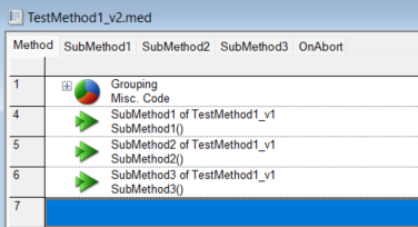

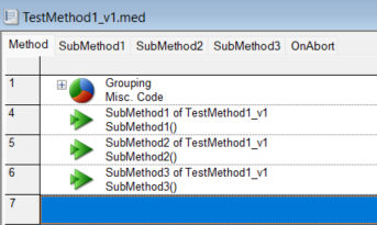

This thread has not been active in a while, but I’d like to submit a feature/bug fix request. I have not yet used Venus 6, so I don’t know if this is already implemented. I’m just going off of my experience with Venus 4.
There is a graphical glitch in the Venus 4 method editor that displays incorrect sub-method names. After saving a .med file with ā€œSave Asā€¦ā€ and changing the file name, the sub-method calls are still displayed with the previous name. This persists after closing and reopening as well as saving again. See the example below where I saved ā€œTestMethod1_v1.medā€ as ā€œTestMethod1_v2.medā€:
At first I thought this was causing the method to call sub-methods from previous versions of the script. Thankfully, I know this is just a graphical glitch because the HSL file uses the ā€œ__filename__ā€ keyword when importing local sub-methods, and in testing, added functionality after saving is preserved.
If the local sub-method call displays cannot be changed with ā€œSave Asā€¦ā€, then can we get an option to reload them? Maybe something like this:
Again, I don’t know if this has been resolved or not in Venus 6.
Double clicking on the sub method call resolves this. I have several method where sub method calls feature historical names of the method when they were implemented.
