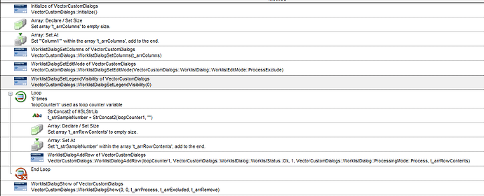

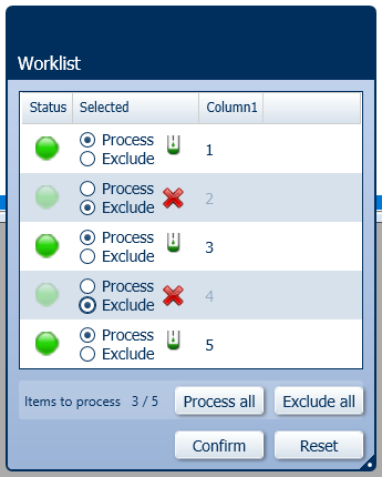

The Worklist option is great for this example that you mentioned. See below a simple example:
Code
Dialog
Results
There are several functions that are marked as WorklistDialog that are specific to these functions.
There are also global variables that are also specific to these functions.
You need to specify the columns first using the SetColumns function and feeding in an array of column headers. Keep note of the number of items you include, as your AddRow arrays need to have the same number of times.
You can specify whether the worklist is editable or not, as well as what the starting status/selection is if you want to pre-make decisions for the user.
If you want to show the user a number, make sure to convert it to a string first, as the library only accepts array of strings for its values.
The ID that you set to each row, needs to be unique and an integer. I typically use the loop counter for the loop I use to make the dialog. The ids that are in the output arrays correspond to this value which allows you to tie that ID back to source data so you can add/remove sequence positions or values down the line.

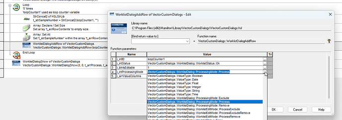

is it possible to automatically assign “exclude” flag into the UI or is this the design of the UI screen for the user to handle this ??
Hi @Optimize ,
That would be set on the WorklistDialogAddRow command on what the default would be:
In my example, I used Process, but it could have been set to Exclude so that the user has to select something to be processed.
