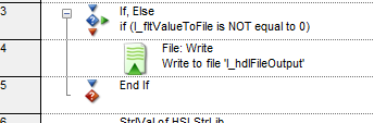

For your second question, there are a number of ways to go about only writing a set number of values to the file, but how to go about it depends on how your method is written. One option is to use a conditional statement (If, else) that checks the value being written to the file, and only write if it’s not equal to 0:

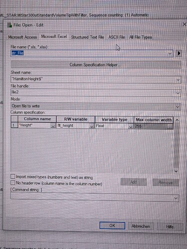

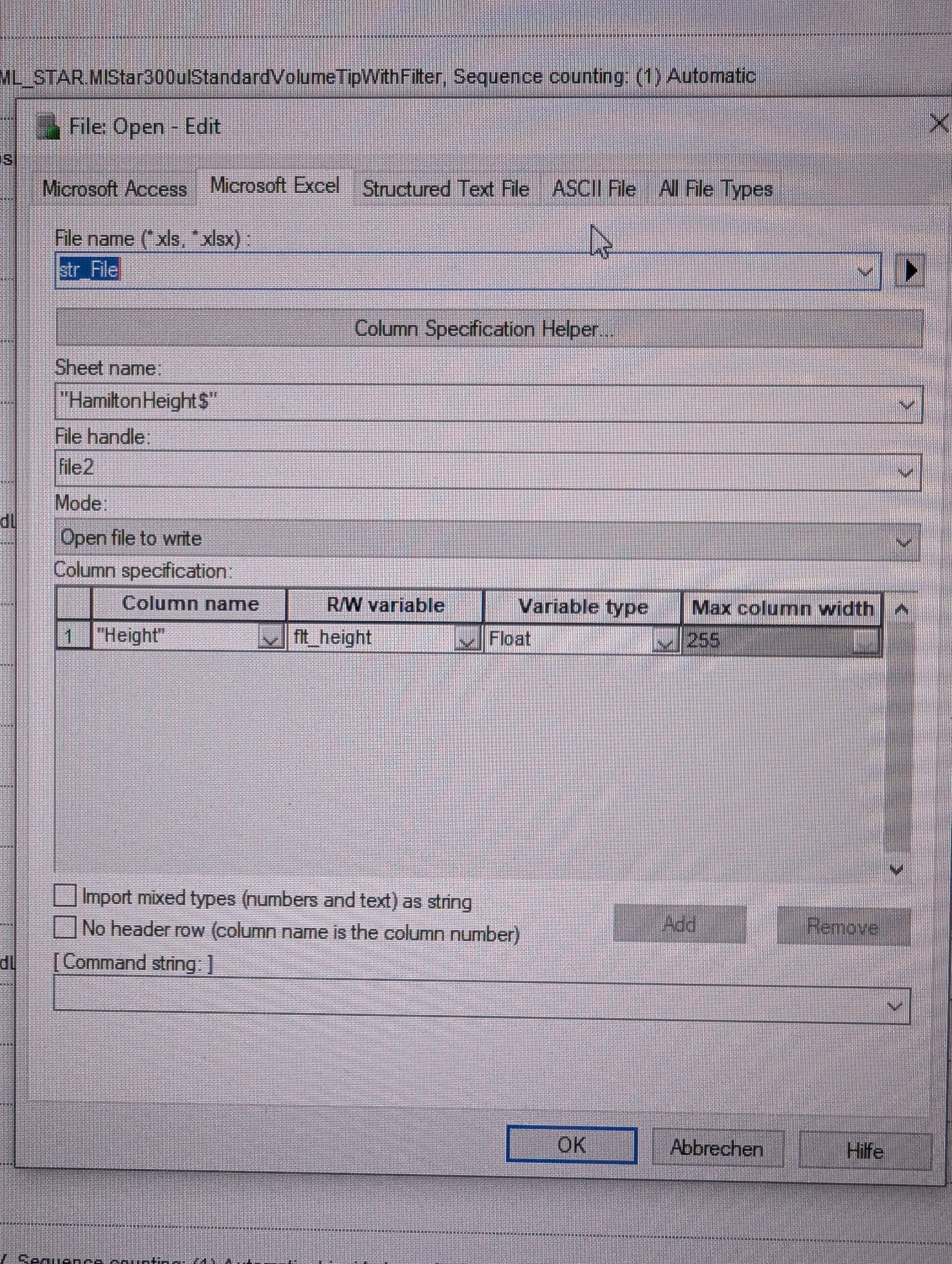

Here is the open method I am using (sorry it’s only a screenshot, our company blocks this website so I do everything in my cellphone)

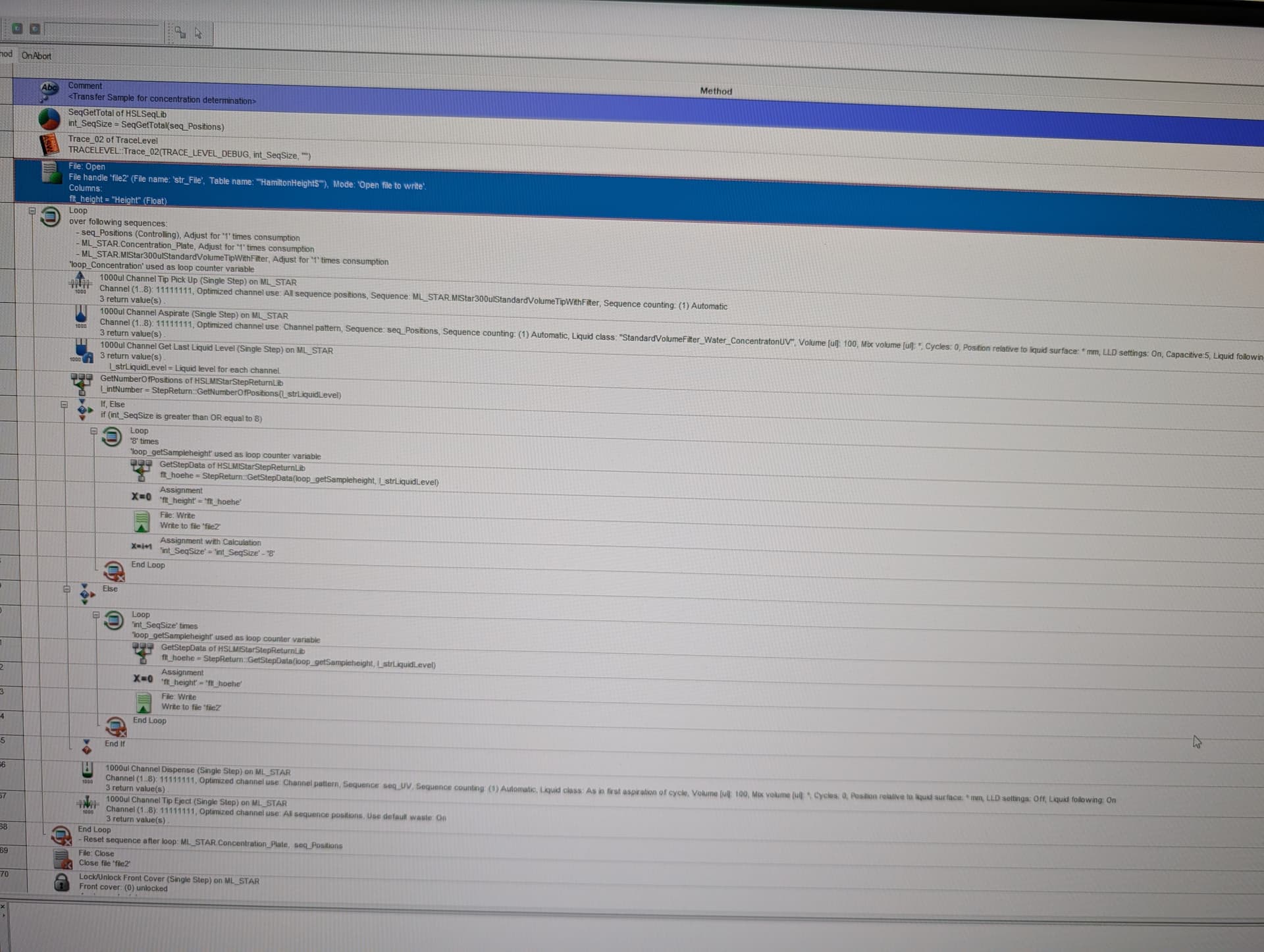

If it might help this is the rest of the block that writes the values:
Heiko
Can you try it again and place the open and close command for the file inside the loop?
Hey, no that did not change anything
