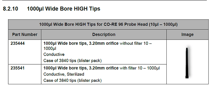

We received new Tips for us. '1000μl Wide bore tips, 3.20mm orifice without filter 10 – 1000μl
Conductive" Part Number - 235444. I notice that they are shorter than typical tips for 1000 such as “1000μl Standard Tips”. Does anyone has experience with that tips? I mean, maybe there is a way to create new tips, kind a file? Because the Software shows only this. See the picture. Thanks!
Please refer to the following thread which provides a link to the installer for versions before VENUS 6.
https://forums.pylabrobot.org/t/hamilton-wide-bore-tips-not-touching-bottom-of-plate/2689
Thanks! It helps!
