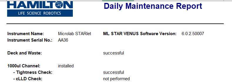

Hi @Stefan ,
Has the system passed daily maintenance?
I will give that a shot next time im in lab. Thanks!
@BrandonBare_Hamilton @EricSindelar_Hamilton
Update: Looks like daily maintenance passes for the tightness checks and I can definitely see the plunger screws moving. It’s odd that some of the channels aren’t working correctly only on the mixing step, and the aspirate works fine. Seems pretty likely that this is an issue with how the command is being run, maybe labware geometry/ liquid height as well. I will run some more tests and update with my findings.
