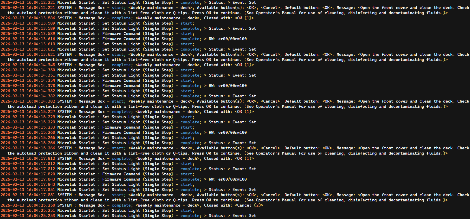

Hi folks, this isn’t a syntax error in the exact same way but it is a maintenance issue and I’m hoping it has a similarly simple fix. I’ve been running 6.3.2 on my personal machine for a while with no issues, but when I attempted to start putting it on the dedicated instrument PCs, I can’t seem to get through daily or weekly maintenance. Instrument connection/control runs fine, as will methods in general, but maintenance specifically keeps looping on the first user prompt to clean the deck. The same STARlet will complete maintenance with no problems when connected to a PC running 6.2.1.
Possibly helpful info:
  • Three different PCs failed to progress through the maintenance methods in the same manner
  • The PCs are running W11Pro or Enterprise, all with hardware that more than meets the recommended specs
  • The enterprise machine is a slightly older install, but the W11Pro PCs were both fresh installs within the last week or so
  • The STARlet in question is one of the older ones, like B-range serial number old. Recently PMed, but does not have the status light in particular.
  • I did try copying in the maintenance files linked above, no change.
Screenshot of the trace file, can provide further info if needed:

We do in fact have 12 channels on this instrument, however that does not seem to have fixed things unfortunately. It’s still looping at the same prompt as it was before.
Hi @labrat,
Please send me a copy of the two files on your PC from my original reply (HslStarLineMaintMetLib.hs_ and HslStarLineMaintMetLib.stp, in the Hamilton\Library folder) and a copy of a trace file with the loop so I can review.
Can do! Would you like them as a DM attachment, or via one of those upload link locations?
Hi @labrat,
Either way works, whichever is easiest for you.
Just uploaded, I hadn’t realized the file upload links trickled throughout the forum all went to the same central folder on your end. Just to double check, the files I sent were the ones I had backed up that were from my original install; those were what you were aiming for, correct? As opposed to the new/overwrite copies you shared yesterday
Either way, I’ll note that the trace file I shared was from the attempt after pasting in the new library files.
Hi @labrat,
Thank you for uploading the files. On further review, everything looks good with the maintenance files themselves, and I realized that the infinite loop you’re stuck in is unrelated to the bugs I mentioned before.
The issue here is the maintenance protocol checks to make sure the system’s cover is open after clicking OK on the dialog, but the trace is showing that it is closed. If the cover is open in your attempted runs when clicking the OK button and you continue to have this issue, then you might have an issue with the door sensor itself and should reach out to your local support representative to come out and take a look.
