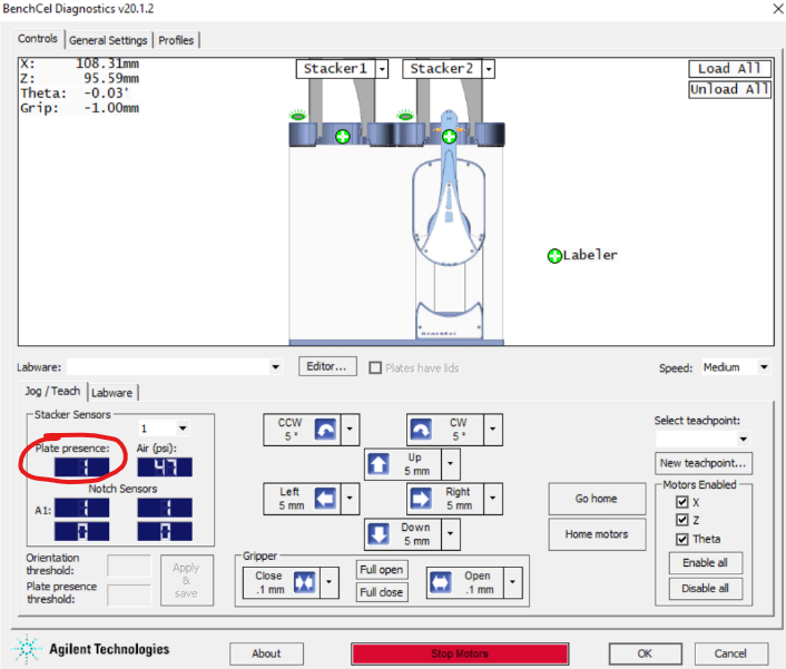

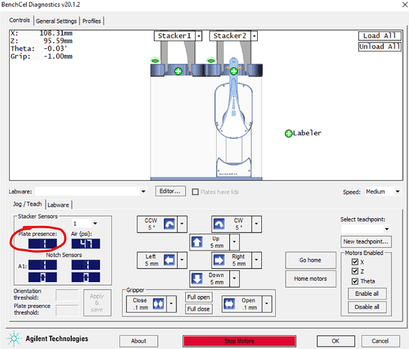

Does anyone here know how to access a BenchCel stacker’s plate presence sensor value in javascript?
It would be really nice to be able to use a while loop to run a protocol as long as a plate is present in the input stacker.

I found this!:
D0004458_BenchCelActiveX_UG.pdf (SECURED)
