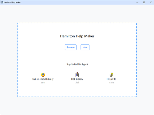

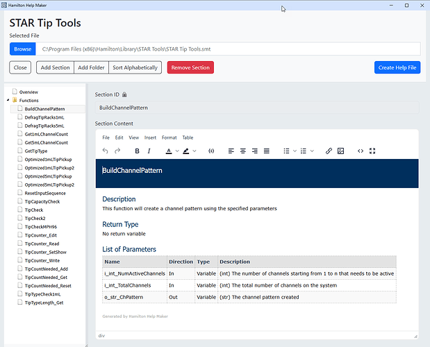

See this link for the new Hamilton Help Maker.
This tool automatically generates .chm help files from any given HSL or Sub-method library.
Functions:
  • Create help file from .hsl or .smt
  • Create new blank help file
  • Edit existing .chm files
  • Editable navigation tree
  • Content editor and HTML code editor
  • Copy/Paste images, Excel and Word formatted data
Notes:
  • No installation needed, just extract the .zip and run Hamilton_Help_Maker.exe
  • If Microsoft HTML Help Workshop is not installed when clicking “Create Help”, the app will try to install it. If your IT policy blocks this process, you can manually run the installer from \HTML Help Workshop\htmlhelp.exe
Many thanks to @AlvaroCuevas_Hamilton for this new tool!

@EricSindelar_Hamilton and @AlvaroCuevas_Hamilton , I have been experimenting with this tool and I have a question.
In some Hamilton Libraries, the Overview page lists out all the functions that have links that can be clicked on to bring you to the specific function page.

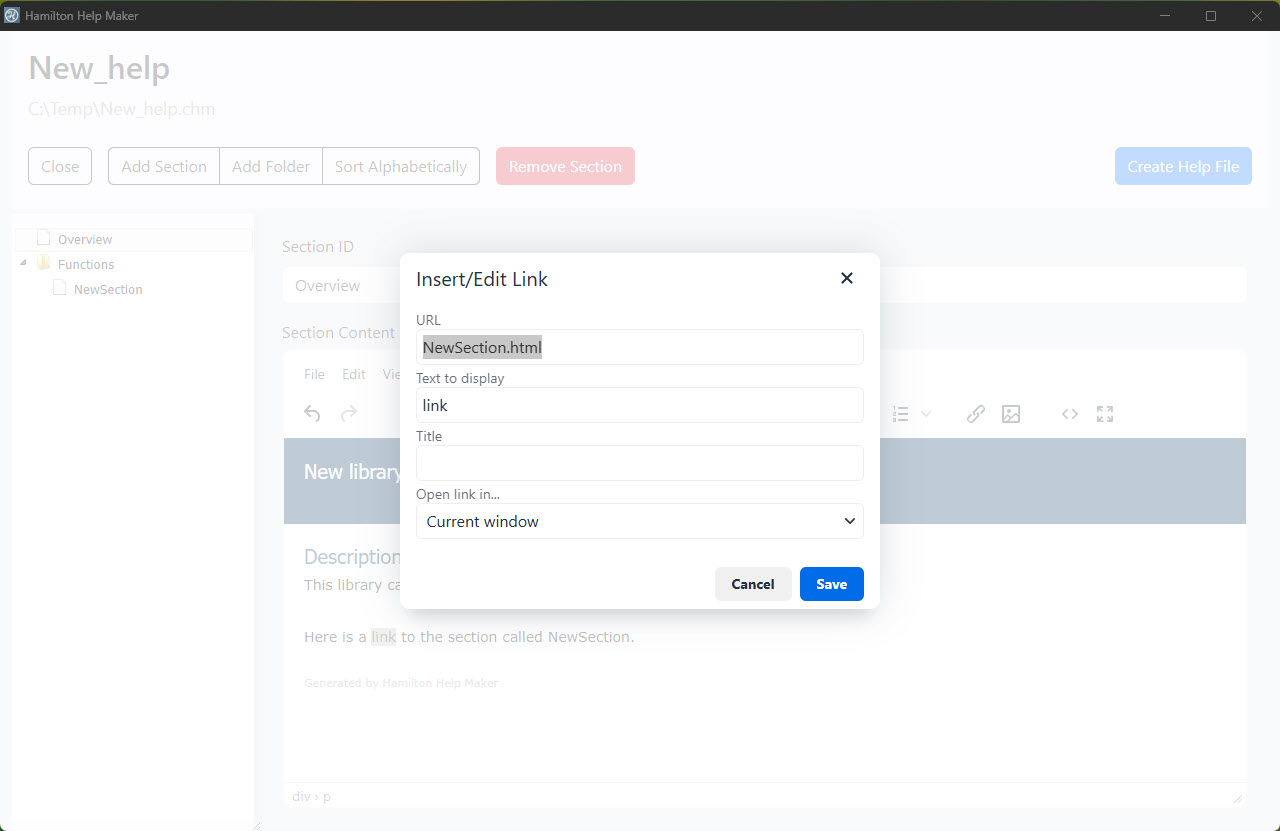

I see in the Hamilton Help Maker the option to add a link, but how do I know what URL to use to represent the link to my specific function page? Or is that not possible with this tool? When I try to open an example library that uses links in that way, the Overview is just a white screen. Thanks!
You should be able to link to sections that you create by specifying the URL for the link as the name of the section you want to link to plus “.html”.
Please see the attached image for an example.
