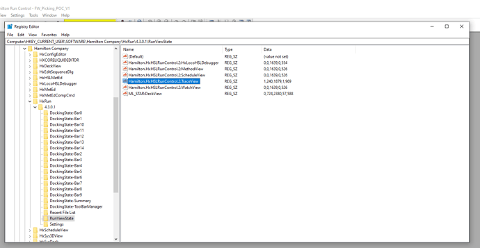

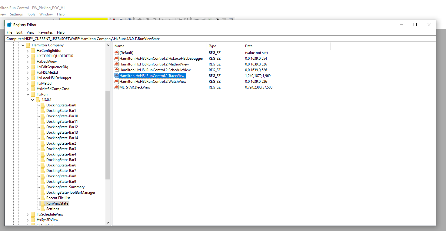

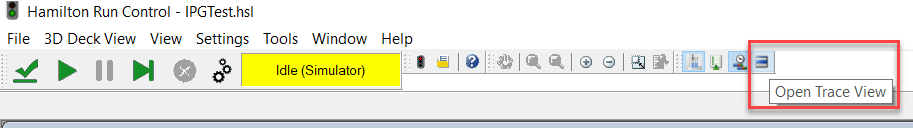

If the trace view window cannot be toggled in run control
Then I would check the following registry values for the affected user:
The first value of the comma delimited value set would be 1 or 0 based on whether the view is toggled active. The rest are the left, right, top, bottom (not sure on the order) but you get the idea.
