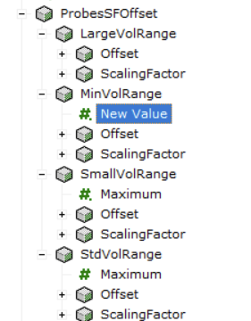

My thought is this - the i7 only has three volume groups - Small, Standard, and Large - but I’m curious if I could add a new group to the mix and if the software would actually recognize this group when making decisions on which calibration to apply.
I can add the dictionary in easily, but I’m weary to do this my real system for fear of bricking the instrument (bad) but I’m not sure if I can test this in simulation, or how to determine if the scaling is being applied to the pump movements.

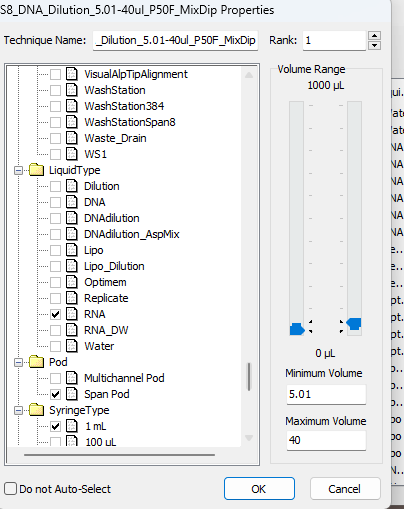

I wouldn’t now how to do it that way, but I wonder if you can figure out a way to build multiple techniques for each volume range, and set a rank for each of those in such a way that in your transfer/aspirate/dispense command, that it will autocorrect the correct technique (with customized calibration).
If you aren’t using auto-select at all, then you could set all of other techniques to “do not auto-select”, and only do that for the for the techniques where you need 1 ul transfers. If you had multiple different types of liquid that each required their own specific calibration offset/scaling factor, then you might have to set up different liquid types to make the auto-select work properly in that case.

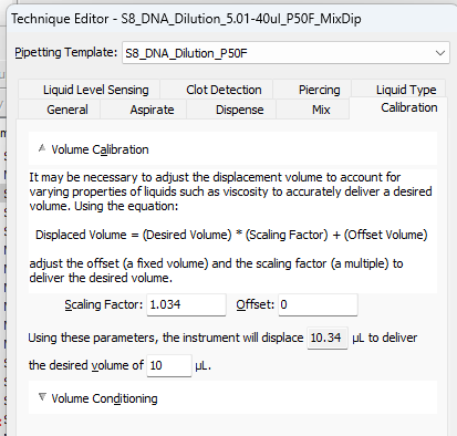

I tried out adding the dictionary - it did not work. Individual liquid techniques or script scale/offset modifications are the way to go.

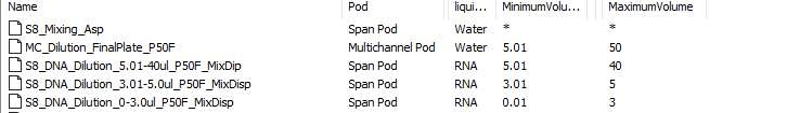

You can utilize a technique on the browser that supports multiple techniques based on the volume you wish to aspirate. This range can then be calibrated using a scaling factor. Additionally, you can set the technology to auto-select. The process operates based on the volume you’re working with, selecting the appropriate technique that has been calibrated.
*or example:
  • The first technique is suitable for volumes between 0.01 and 3, with a scaling factor of 0.93.
  • The second technique is suitable for volumes between 3.01 and 5.0, with a scaling factor of 0.95.
  • The third technique is applicable for volumes between 5.01 and 50, with a scaling factor of 1.034.

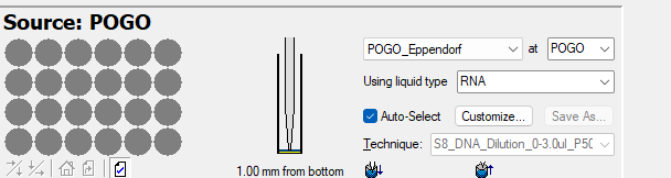

When working with a liquid type named ‘RNA’, during the transfer process, select ‘RNA’ as the liquid type and click on ‘Auto-Select’. Based on the volume, the software will then choose the technique that best matches the volume.
