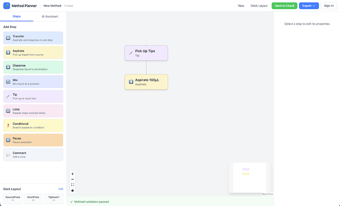

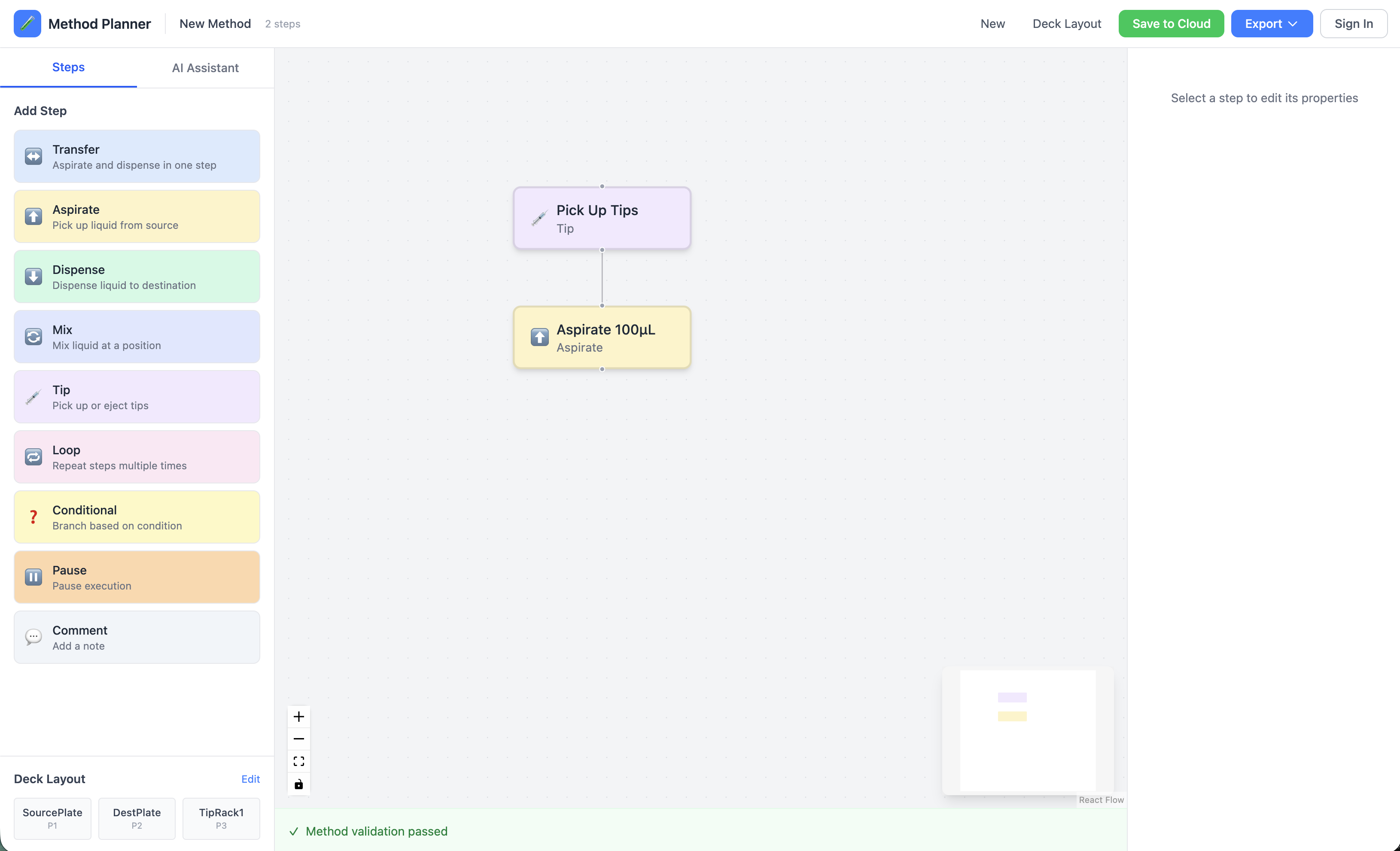

My question then is, are you all using AI to develop methods? If not, why?
Thanks
I ask because I’m contemplating building an open source interface similar to Venus, but with AI Assistance and HSL export
