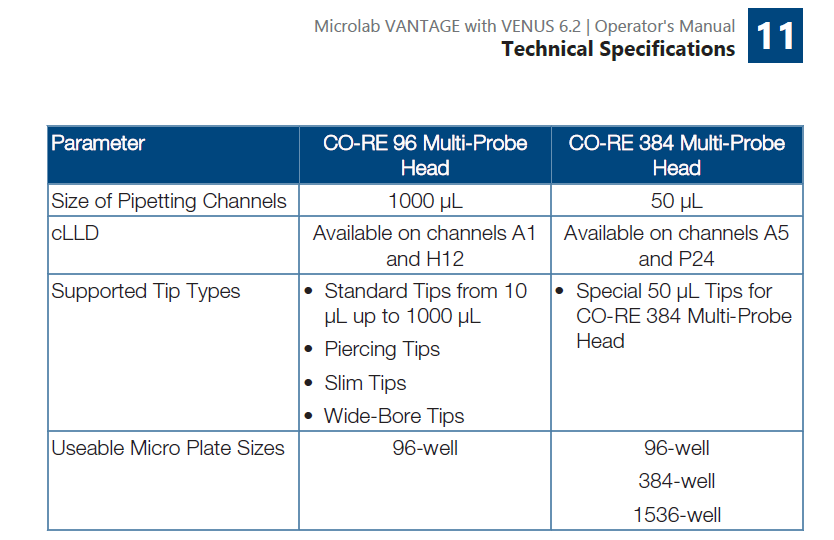

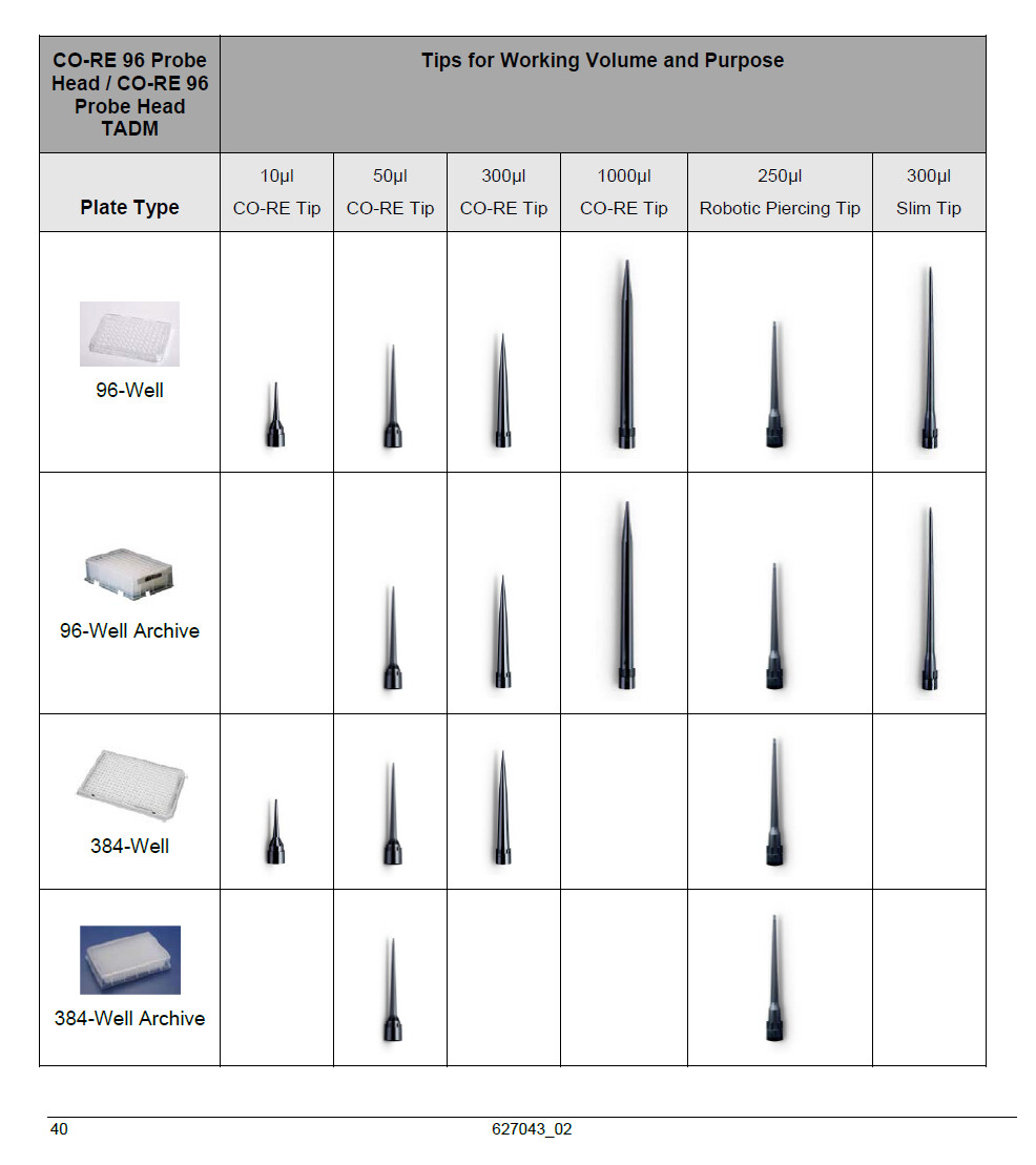

Following up on this, I reviewed both the VENUS 4 and VENUS 6 Operator’s Manuals. Below is the table from the VENUS 4 manual:
And here’s the table from the VENUS 6 manual:
There’s a discrepancy between the compatibility of the CO-RE 96 Head - VENUS 4 manual states that it can be used for 384-well plates, while VENUS 6 manual states that it’s only compatible with 96-well plates. I’m a bit confused since the CO-RE II upgrades with VENUS 6 would theoretically make tip alignment better, so I don’t know why 384-well plates were removed here. I’ve been using the CO-RE 96 Probe Head for years with success for 384-well plates so I don’t think that the VENUS 6 manual is necessarily true.
@EricSindelar_Hamilton , can you please clarify the above? What are Hamilton’s recommendations for tip type-labware compatibility?
The VENUS 4 excerpt is more helpful in this instance as it shows that Slim tips are not recommended for 384-well plate types with the MPH96. Due to their length which is approximate to the 1mL tip, any skewness will be exaggerated by the end of the tip making it not suitable for higher density plates. Slim tips are ideal for avoiding excessive liquid displacement in tubes and thinner wells compared to 1mL tips, and generally speaking, are more often implemented with the 1mL independent channels.
I’ll follow up with the internal teams on the table included in the VENUS 6 manual - it tried to consolidate the info but doesn’t give as clear of a breakdown.

I am trying to create a method where I need to pipette in and out of a 384-well plate. However, my volume range makes it so using the 50ul tips would significantly increase the time and tip usage for method completion. From this thread, the slim 300ul tips are not recommended for 384-well plates but the image above shows that the 250ul robotic piercing tips are. These would be perfect for my application but I can’t seem to find them for purchase.
