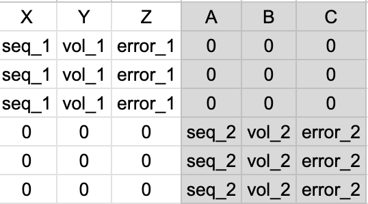

I then tried to define all of the columns in the first time of creating File1. That way, I would write in the variables in columns X, Y, and Z and then write in the variables in columns A, B, and C afterward. However, my file ends up looking something like this:
Screen Shot 2024-07-24 at 11.10.27 AM

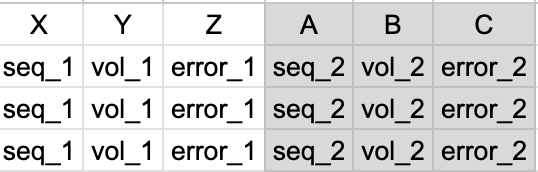

When I want this instead:
Screen Shot 2024-07-24 at 11.09.58 AM

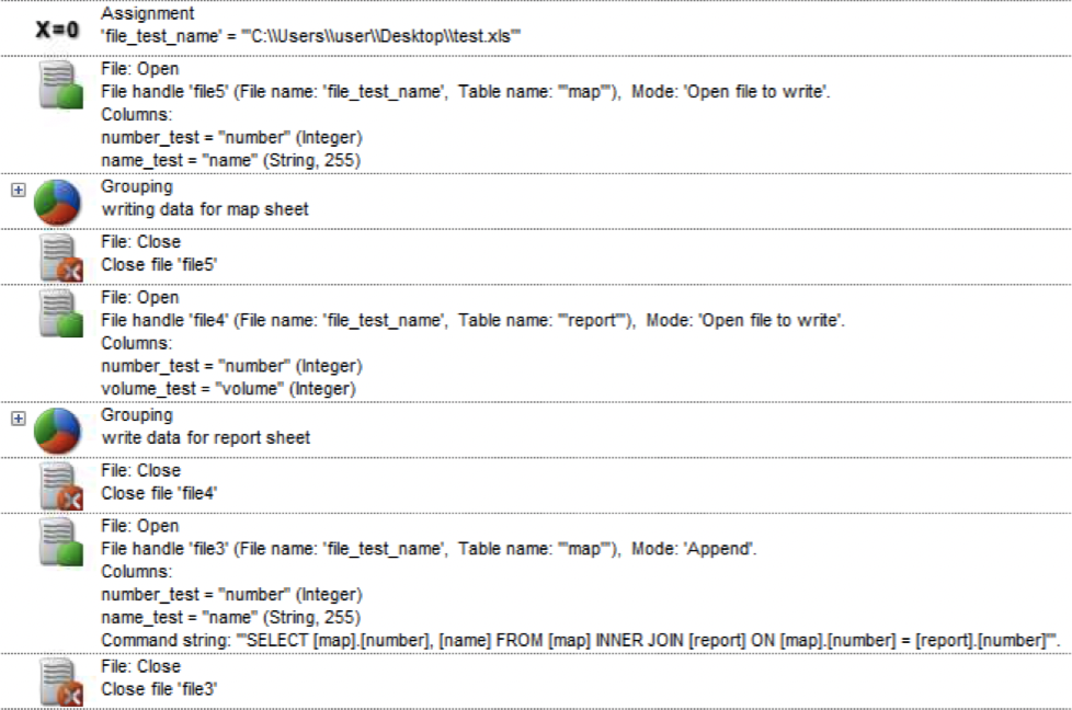

Does the JOIN command depend on the version of Excel we have? I am following the example linked in the original post and, although I am not running into any errors, my two tables are still unmerged at the end. I made other modifications to try to resolve the issue but to no avail. I could be missing something but here is my method for my test run (alongside the two tables I want to merge based on “number”).
SQL_command = “SELECT [map].[number], [name] FROM [map] INNER JOIN [report] ON [map].[number] = [report].[number]”
