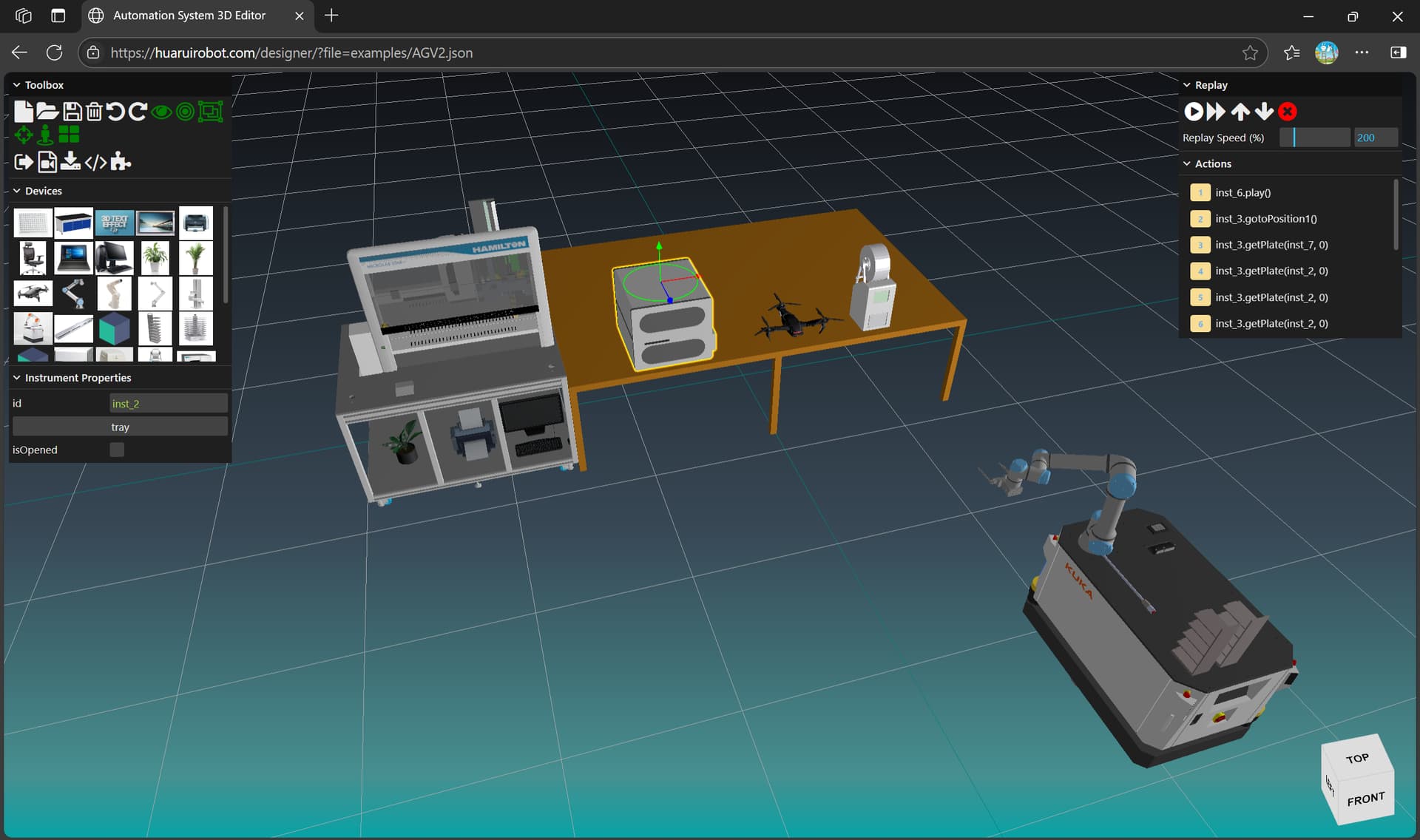

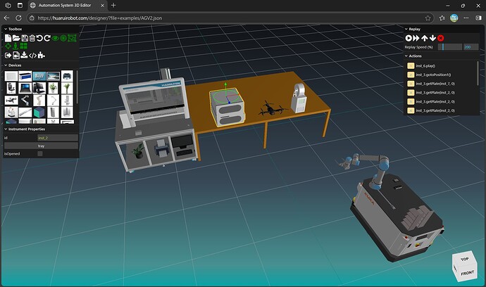

you can check the system of following image with this tool, to test functions of this tools.
With this simulation tool, you can drag instrument to the scene, setup your system, customize each instrument (arm type/gripper type/door handling), check plate transportation, record and replay these recorded actions.
Also you can add your models to scene, download glb file of scene, write/execute javascript to control all these instruments (event digital twin is possible, if you can setup a web service to get the details of your instruments)

Instruction to use the simulation tools.
  • add instrument to scene
    click on instrument in the list and move the instrument to position you want, or drag the instrument in the list to position that you want
  • move/rotate the instrument
    click on instrument and drag to your position, or click on the transformation handler to move/rotate the instrument. Click the button of rotation to rotate instrument.
  • setup/perform action on selected instrument
    click on instrument to select it, set each setting on the left property grid to setup it, or click on buttons to perform actions
  • transport plate
    click on the instrument to select it, and click the “move plate” button in toolbar, the transportation panel will be showed, select robot arm and setup transporation parameter, and then click the “movePlate” button below.
  • mount arm on AGV
    move the robot arm with mouse, move it on AGV or arm rail, and the robot arm will be mounted to AGV or rail.
  • move the gripper with mouse
    click and drag the gripper of robot arm, then the robot arm will move with the moving of mouse. Many instruments support mouse dragging operation, including STAR (arm, MPH, iSWAP, channel) and robot rail.
  • recording action/movement and replaying
    click on the recording button in toolbar, perform the action of instrument or moving plate, then these actions will be recorded to replay list in the right. You can edit these recorded actions, or replay it.
  • add your move 3D model to scene
    click the last button in toolbar, setup your model in popup window. Select path of your model, set the right scale and up direction, then you can add it to scene by clicking on the second button below.
you can see this example, and test all these functions and see the recorded actions in replay list.
