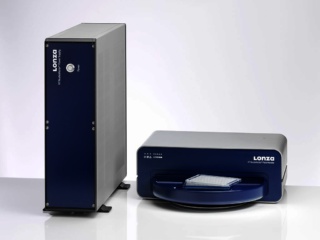

I know Lonza has an automated nucleofection solution that can be integrated with a Hamilton Vantage, perhaps that is worth investigating?

I definitely second the benefits of evaluating the Lonza solution for sure!
I have integrated nucleofector HT onto a STAR workcell. Overall, it went fine if you can stomach the cost of the plate.
