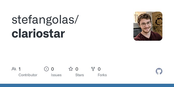

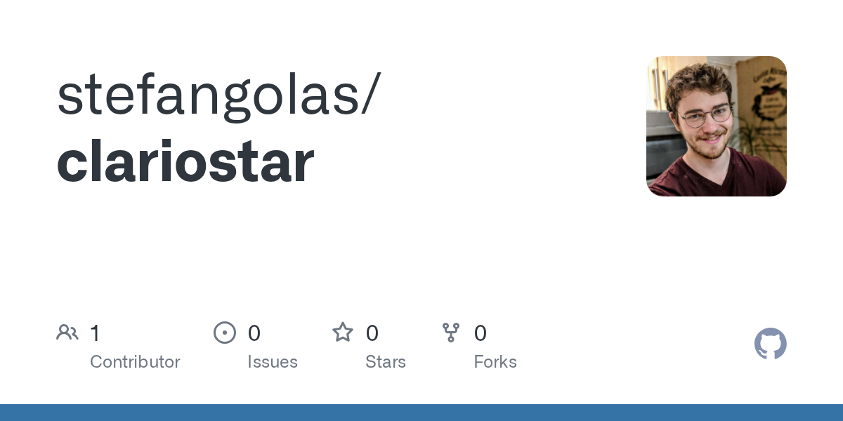

I have a full Python integration of the Clariostar. Let me know if you have any questions about it
