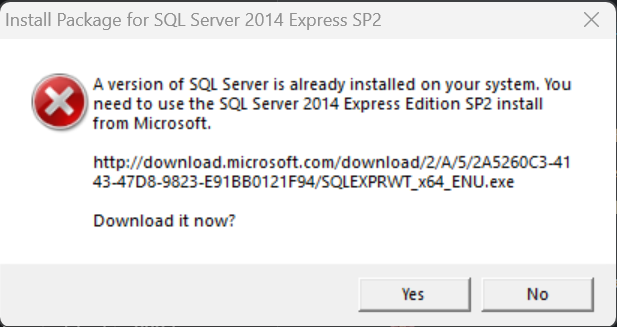

Running into lots of issues with SQL Server and the software installer recognizing the database as the correct version and service pack.

The error is this
This appears with or without SQL installed. I’ve tried versions 2014, 2014SP2, and 2014SP3 but the installer doesn’t appear to recognize the installation state, existing or not.

For my case, I attribute this to the laptop being locked down too much by our IT department and just not being able to have admin over the install process. I wonder if this is the root of all my issues - probably some msi couldn’t run or was getting pushback from system security.

First, I uninstalled all the SQL components normally.
But even so, some folders remained on my system after the uninstallation:
C:\Program Files\Microsoft SQL Server
C:\Program Files (x86)\Microsoft SQL Server
So I downloaded IObit Unlocker and was able to force the deletion of these files. (IObit Unlocker, Solution for "undelete files or folders" Problems on Windows 8, 7, Vista, XP, 10 - IObit)
I restarted the computer, installed SQL, restarted again, and then installed Biomek.
(In one of the attempts, I used Geek Uninstaller, but it didn’t work — only IObit Unlocker did. In fact, with Geek, it deleted some files without properly uninstalling the software, and I even had to reinstall it just so I could uninstall it completely.)

The SQL that came with the Biomek was SQLEXPR.EXE (999,579 KB file), but that one doesn’t work.
I downloaded the one they recommend when the installation error occurs: http://download.microsoft.com/download/2/A/5/2A5260C3-4143-47D8-9823-E91BB0121F94/SQLEXPRWT_x64_ENU.exe SQLEXPRWT_x64_ENU.EXE (1,124,257 KB file)
