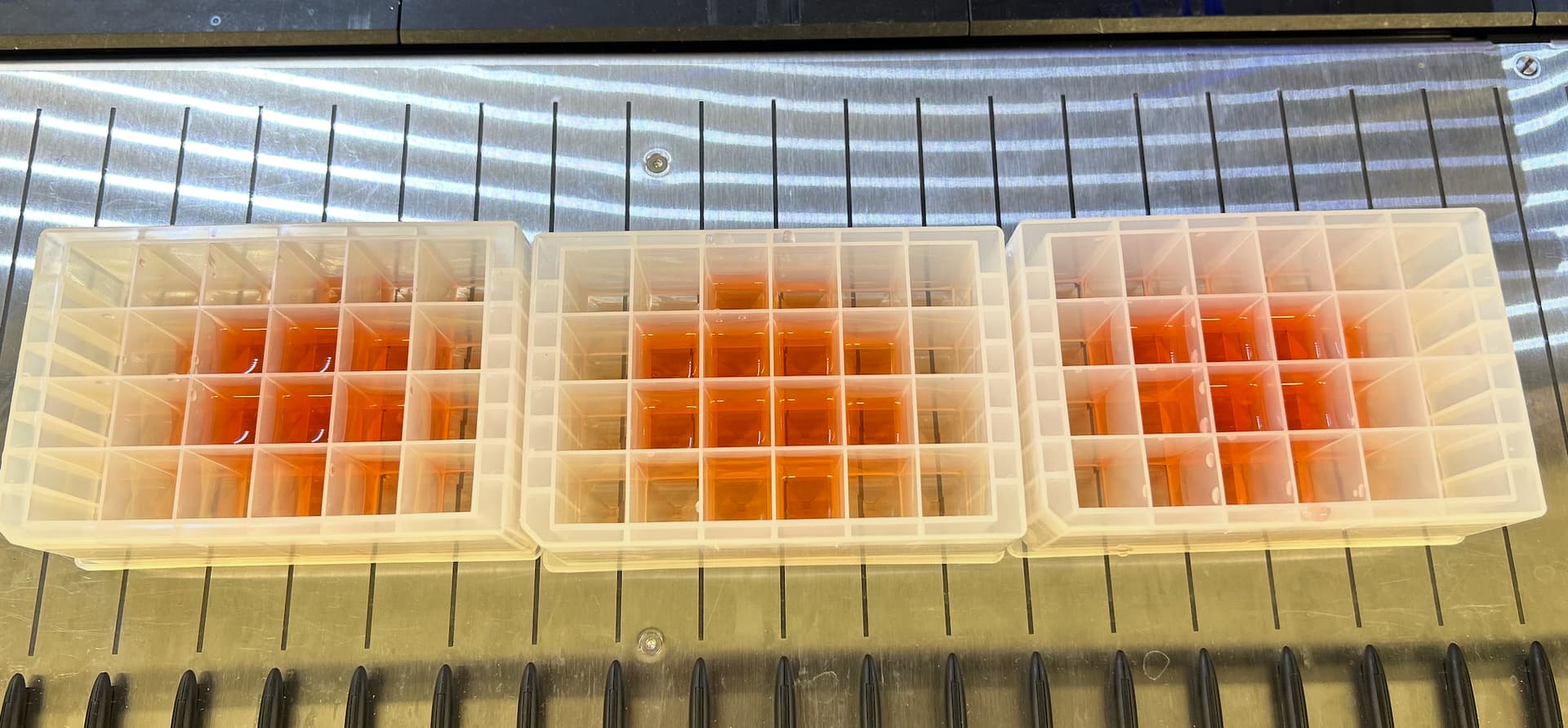

I’ve been using this MlStarIsCoreHeadSpecialTipPickup property and have lately run into an issue where the middle probes do not aspirate after tip pickup, outer edges of the 96 head work better but not great.
This was working fine a couple weeks ago but just started recently. We had service visit recently and they replaced spacer plates, which are supposed to be related but still this issues persists.
Curious if anyone has seen this before and has suggestions?
