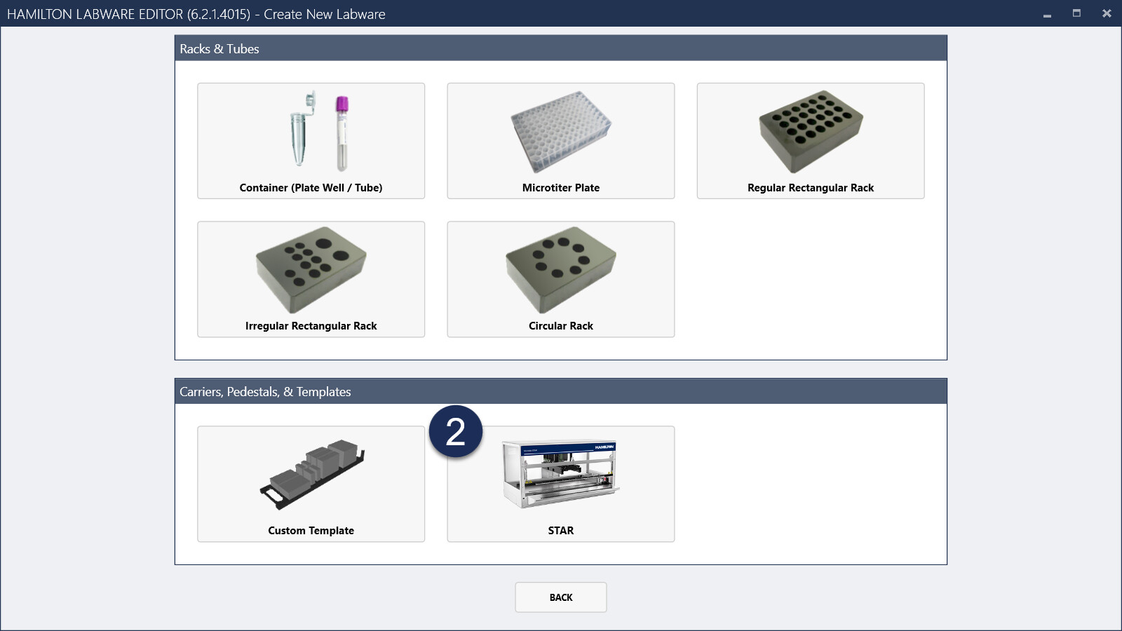

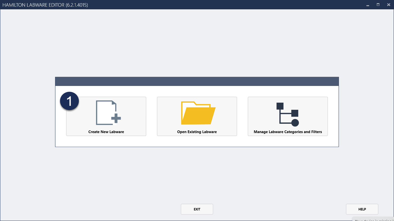

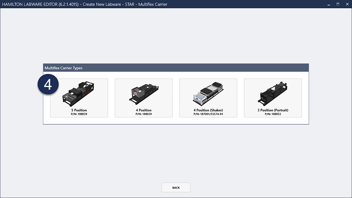

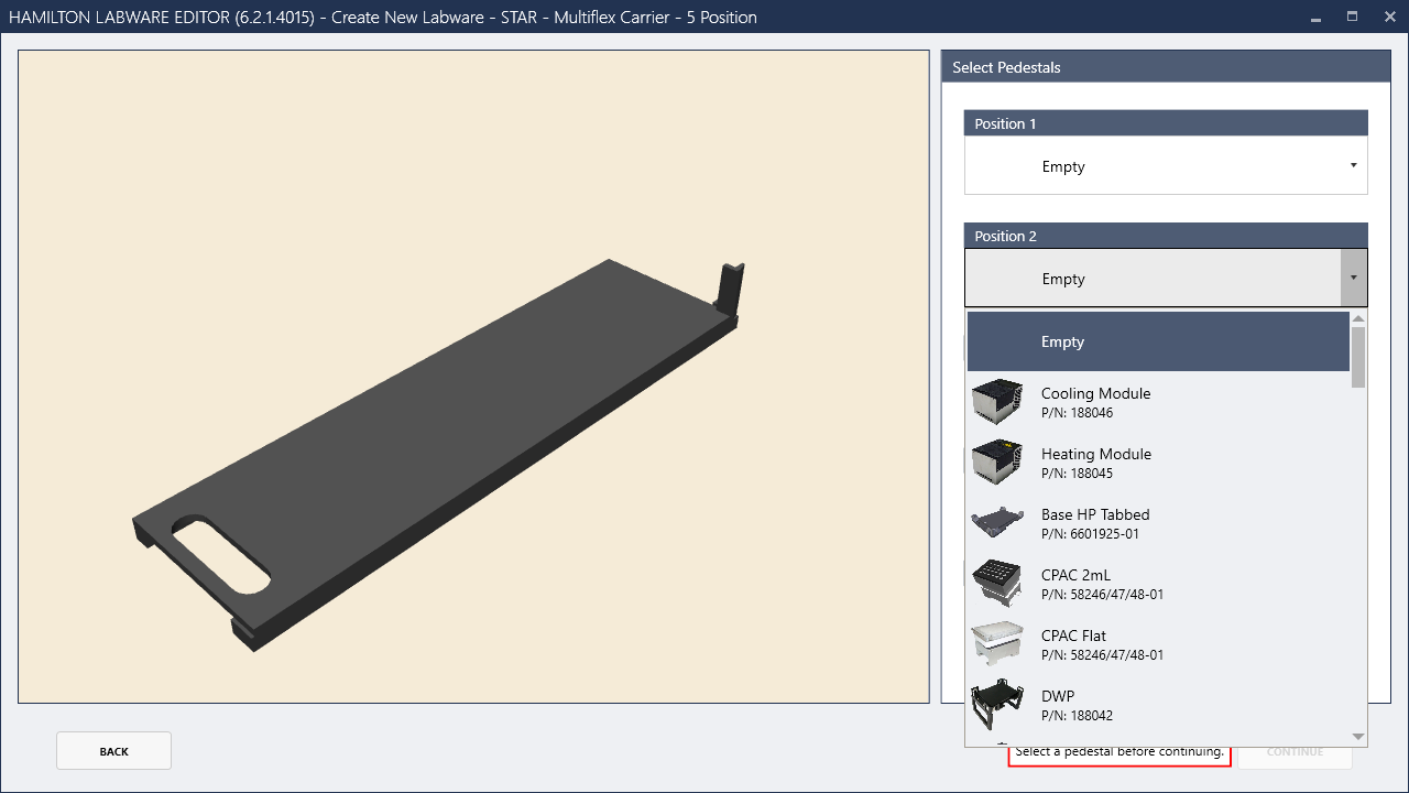

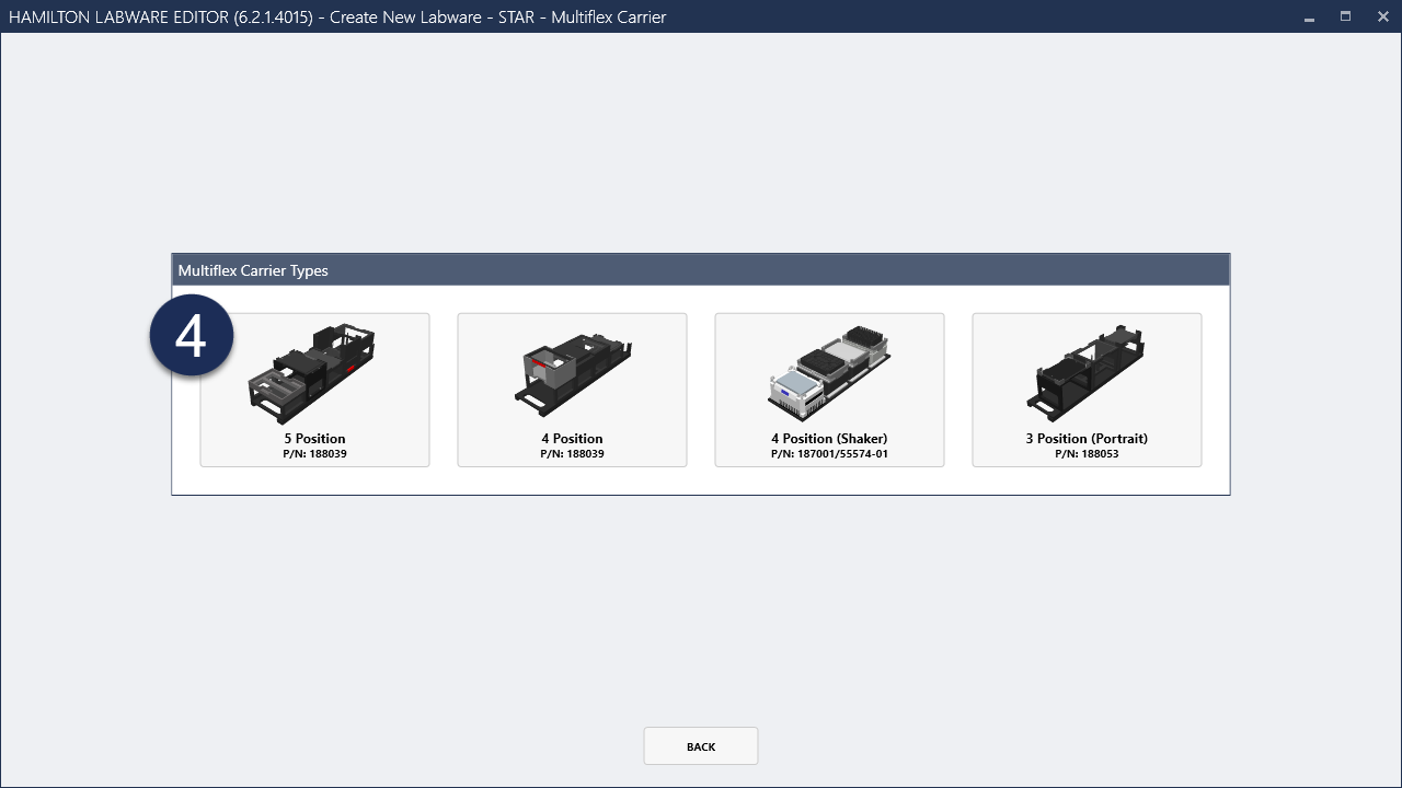

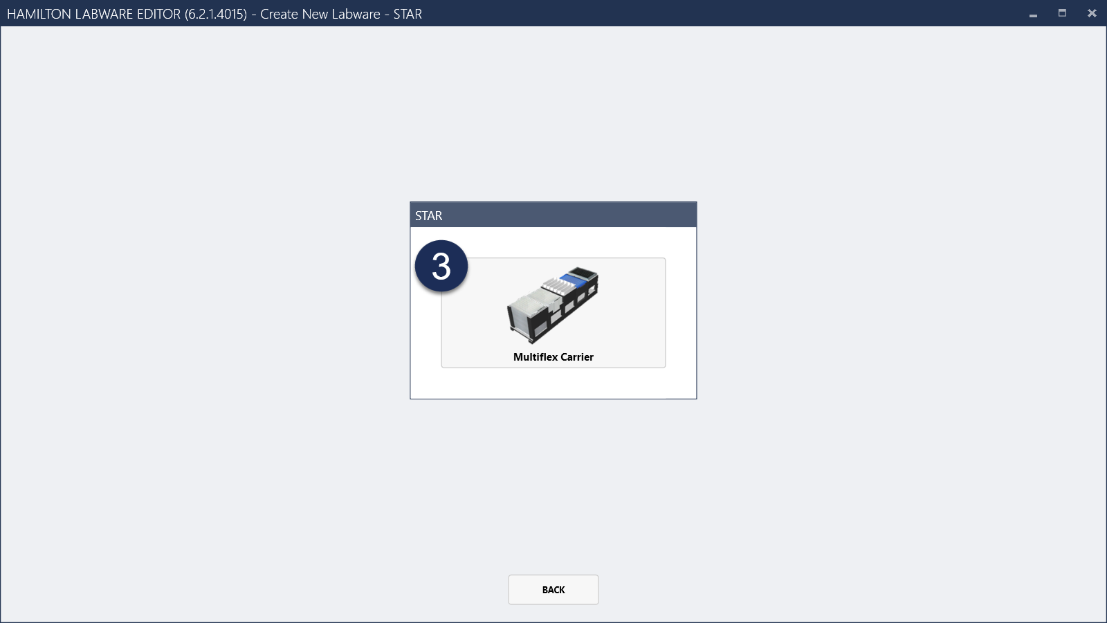

P/N: 188039 is the standard 5-position landscape base carrier for multiflex modules. It’s the same carrier whether you have a STAR or VANTAGE. You can build the carrier with your specific modules via the Labware Editor. The Labware Editor can be found in System Tools via the main UI. See below for the steps to get to the carrier case and builder:
