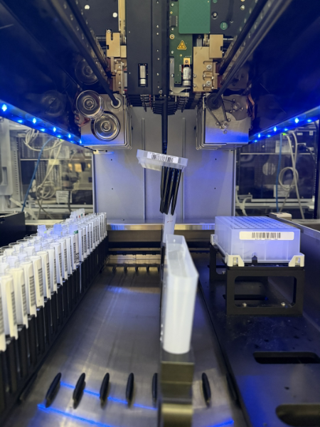

Hi folks, I’ve got a two-part question:
  1. Across multiple STARlets, we’re seeing tip pickup/alignment issues—I’ve played with the tip racks and carriers a bit, and it seems like the tip rack frame (CO-RE II) isn’t clipping fully into some of our newer tip carriers, not even with extra pressure applied. There’s also been a few instances of fully seated tip racks and fully loaded tip carriers being multiple mm off-center when attempting to pick up tips, unsure if the two are related. All that said, the non-clipping tip rack appears to have been part of the issue here:
Main question, is there anything we can do to alleviate this? I’ve seen some of the tip rack adapters that seem to just raise the tip pickup height 10mm or so, would that be a viable workaround here? We haven’t found anything out of tolerance in the recent PMs so it’s difficult to troubleshoot without a good culprit.

Another thought is to swap out the tip carrier. We see a lot of these left out in the sun do what we call ‘potato chipping’ where the twist slightly, causing position 1 or 5 top have poor preformance.
ALL (100%) of your carriers should be labeled with a silver sharpie. When you have problems, refernce that nubmer. “It was STAR H123, 2nd shift, Billy was the operator, Method XXXABC123, using carriers 14, 47 and 5.”
Lots of variables, but the labeling of the carriers helps point out easy to solve problems in a lot of cases.
Yes to maintenance (daily and weekly), and yes we’ve tried swapping carriers. It does seem a bit more prevalent in the newer carriers (appx 1y/o) but it happens on multiple carriers, new and old. Usually not to this extent, but this isn’t the first time it’s picked up a whole rack of tips frame and all.
I do agree that swapping carriers would potentially avoid this specific issue, but I’m more aiming for a way to work around this issue rather than sidelining 1/3 of our tip carrier inventory because it can’t hold the racks.

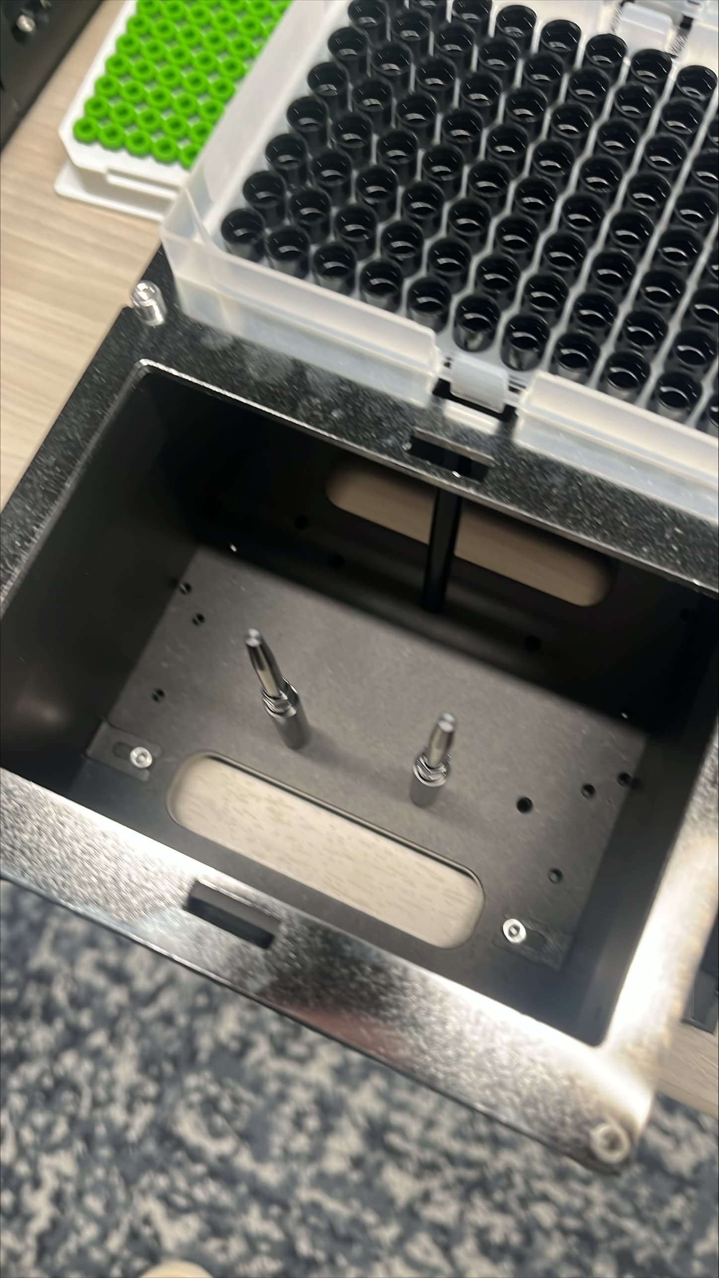

Preface, this was months ago (right when we first used the newer carriers about a year back), so I may be misremembering things: I had brought up the carrier issues to our FSE when they were out for an install/PM, and at the time it seemed like the issue was that they were too new and needed to wear in a bit. That’s been true for the other issue we were seeing then (‘tight’ carrier loading, irrespective of the loading tray angle), but the tip racks not fully clipping in hasn’t really gotten better. It seems like the inner support spindles/plate aren’t fully seated, causing them to sit slightly higher than they ought to, but they’ve been reseated several times.

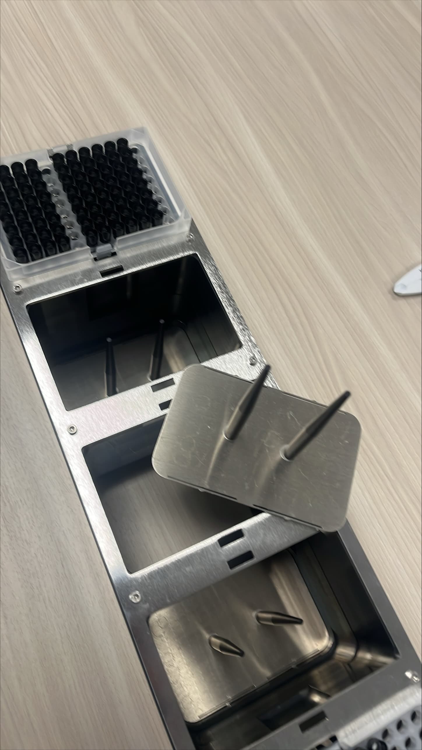

We recently had a new revision to many of our carriers. From the first image which is the new revision you can see that there is no longer a removable center plate that holds the two support bars. If you have the previous revision (second image) where the metal plate can be removed then I have seen cases where the metal edge can shave off the inner plastic of the carrier where the plate fits into place. These shavings can force the plate to sit higher than it should and if it sits high enough then perhaps tip wafers will no longer be able to snap correctly into place.

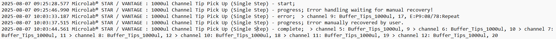

This isn’t exactly a catastrophic tip pick up error, but a tip pick up error nonetheless. I figured that I’d jump on this existing thread instead of creating a new one. We’re experiencing some tip pickup issues with our 1000 uL channels - we have a Vantage 2.0 with 12-span, currently running VENUS 6.3 with CO-RE II technology.
The operator is reporting that there is one channel which fails to pickup tips intermittently. Has anyone else experienced this before, and if so, what was your resolution? Did it have to do with a faulty stop disk or some defect in tip manufacturing?
The operator also reported that they were successful in picking up the tip after several retry attempts. They stated that the channel head may be aiming more to the right, and not towards the end of the tip opening. It’s weird because the instrument passes daily maintenance, and the same channel successfully picks up tips before / after this error.
Please see a snip of the error message below:

A channel alignment check and adjustment may be necessary, but I would check the tip carrier if there’s any obvious issue, i.e. was the tip frame placed incorrectly? was the tip carrier prongs not inserted correctly? Is there play with how the tip frame was loaded? is it biased towards one side?
Daily maintenance does not check channel alignment, only pressure and CLLD.
So probably not a stop disk issue, rather a channel alignment issue? It’s just weird that the tip pickup issue is intermittent and that it works most of the time. The only thing that’s consistent is that the same channel is affected when it does fail to pick up tips
My lab is in the same boat, it seems to only be an intermittent problem so we haven’t chased it further yet; the whole ‘picking up entire racks of tips’ was a bigger issue at the time. While I don’t know the status of the stop disks on ours, I’ve watched the attempted/failed tip pickup and it’s definitely out of alignment during the initial attempt, as well as some subsequent attempts after having it try the next position. It’s been a while but I believe it would successfully pick up a tip after getting to the next column of tips, aka changing the X position rather than just the Y.
