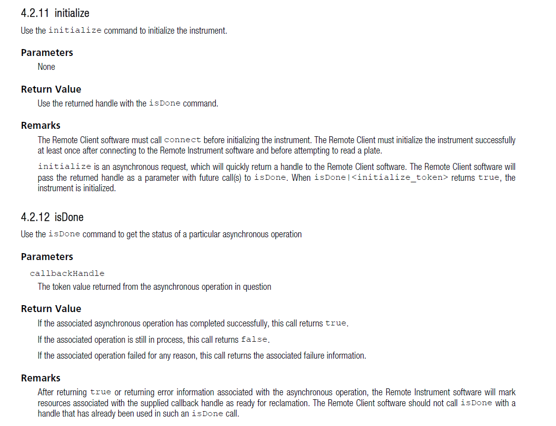

I was wondering if anyone had experience connecting a MSD MESO SECTOR S 600MM instrument to Cellario. I am able to establish a connection, but my initialization keeps failing. I have run the remote instrument .bat file and restarted the instrument several times.
I think you should check if the service is startup and check the port. Other thing did you call the connect before initialize? and use isDone to get status, maybe there are some information you can get .
Thank you for the reply Robin! I was able to get it to connect after restarting the remoteinstrument.bat and then connecting to the driver wrapper.
