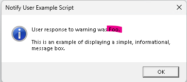

You’re a wizard Harry Duane!
The addition of the quotes and the using directive (which I’d used before, but without the quotes it fails to compile).
Editing to add that it was actually just the omission of the semicolon at the end of the css_reference that is the key. Even without quotes it should work. I guess everytime I did it I was using a semicolon at the end and that’s incorrect. And, of course, that in addition to the using directive.
