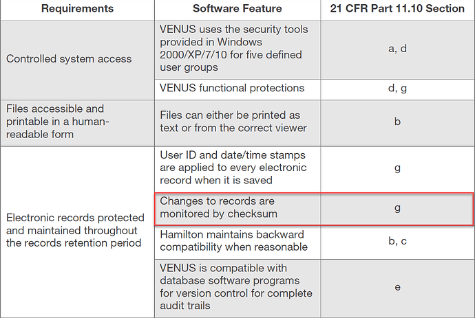

From Hamilton’s standpoint, Checksum Verification is a necessary feature for regulatory compliance and to ease the submission process for individual labs or projects seeking IVD (or IVD-R) labeling, as well as just generally any laboratory adhering to 21 CFR Part 11 guidelines, specifically “Validation of systems to ensure accuracy, reliability, consistent intended performance, and the ability to discern invalid or altered records”:
