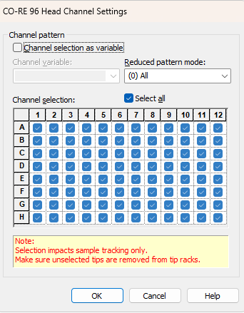

I know its been almost a year, but a question about using the tip support. I’ve loaded the tip support with the number/pattern of tips I need, and unselected the channels on the MPH that I don’t need, but I’m getting an error that all 96 positions are needed on the tip support in order to do tip pick up. Is there a way to bypass this error? Thanks!
I’ve been here. You need to select all channels. The 96MPH channel head doesn’t actually know if there is a tip at any position, it more acts like a stamp. It tries to pick up a tip and if one is there, hey great! If not, it just goes about it’s business.
If you have set up the correct tip pattern on the Tip Support it will pick up the pattern.
Thanks for the comment! I just tried doing that and it keeps giving me the same error unfortunately. It will only let me use the sequence I used to add the tips to the tip support, which is only 72 tips, so it keeps saying there are not enough unused spaces on the tip support
Does your tip support sequence also have 96 positions?

Yeah I have that, but it won’t pop up as one of the sequence options for where to pick up tips
Hmm that’s strange. Have all the positions been consumed, did you try resetting the Tip support sequence to 1? I don’t think that would be it but who knows.
Also are you using the Core 96 head Tip pickup step (not the individual channel tip pickup), the buttons look nearly identical.
Ok so I just thought about what you said regarding the tip support sequence, does your tip support sequence have tips filled in or is it just the positions available in the tip support?
Its just all possible positions on the tip support, so 1-96. For what you are doing you would have 2 sequences. 1 sequence of the tips in a certain pattern that the 8 channel made. Then you would have a second sequence of 96 positions (all positions) that the 96MPH uses.
Again, it could care less where the tips are, it just sort of stamps down and picks up any tips that happen to click into the channels.

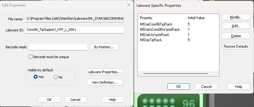

Can I ask what your Labware Specific Properties are for your Tip Support?
My MlStareCore96TipRack value is -1 and I’m wondering if thats causing issues
I didn’t set up this .lay, I’ve been modifying one that was already built for our use. But it doesn’t seem that I have any labware specific properties for the tip support.
Hi @InnerKK ,
If your tip support has a MlSTarCore96TipRack of -1, that means it is using the definition which is meant for STAR MPH Tools. That library will do the tip management for the tip support and will dynamically swap that parameter based on the tip type being used. If you are not using that library and are manually handling the tip sequences, you will need to adjust that parameter to match the tip type being used.
There are also specific labware pre-loaded with the different tip types like the one mentioned above by Christina that you can use.
Thanks for the explanation Brandon! I changed the values to match the 50uL tips and it works now.
