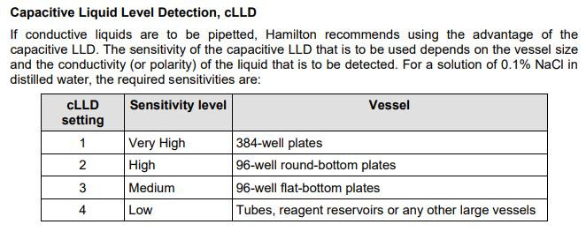

I have been looking for an indication on how to interpreat the sensitivity of the cLLD. From your last answer @DanHartman_Hamilton , it seems that a higher sensitivity will make the conductivity sensor trigger faster and thus potentially too early or even mid-air in case of uncontrolled humid environments?
Setting the sensitivity on Low could potentially help in elinimating false/too early detections?
Below a screenshot from the Venus manual that seems to recommend to increase sensitivity in case of smaller volumes, is that the correct interpretation?

Source: Page 312 from Venus 4 programmers Manual
Hi @weiyolan,
All of that is the correct interpretation. It is more difficult to detect smaller volumes of liquid, which often coincide with smaller containers in a labware, so the table from the manual focuses solely on that aspect. The description in the manual also mentions the conductivity of the liquid, which plays a role in that less conductive liquids will require a higher sensitivity for detection. Lastly, vapors and droplets can trigger cLLD early, so there are considerations regarding both sensitivity and that possible need to switch to pLLD or a Fixed Height. In the end, testing will be required to determine the exact LLD parameters to use for a given transfer.
