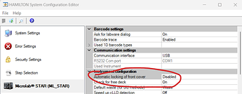

There’s a setting in the sys config that might help. However, I think there needs to be a change applied in the service software as well to full disable door locks.
The cover monitoring is set in the service software and should be enabled for safety. This is typically confirmed during installs and PMs by the field service engineer. The system configuration editor in VENUS can then allow for the automatic locking of the cover during runtime.

We changed to “Disabled” and it still works only with 8-channel
I understand about safety, but sometimes we need opened door. From your words, we can’t change it?
The door should be closed during runtime and only opened during user prompts when the system is not in motion. It is our current policy to not disable any safety mechanism on our platforms.

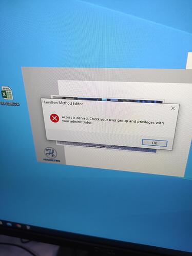

okay then, could you help with this erro?
It looks like you have user authentication enabled on your system so the current user may not be added to the appropriate user group.
The user authentication system and its setup are covered in the programmer’s manual. If you still run into issues, then I recommend you get in touch with your local support to best resolve.
